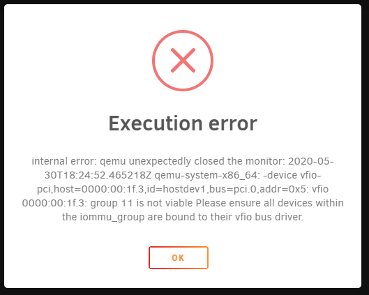

Followed latest passthrougt video from Spaceinvader One so i can run a VM from my existing baremetal NVME installation and also assign one of my mobo's USB controllers but when i start the VM i get the following error:

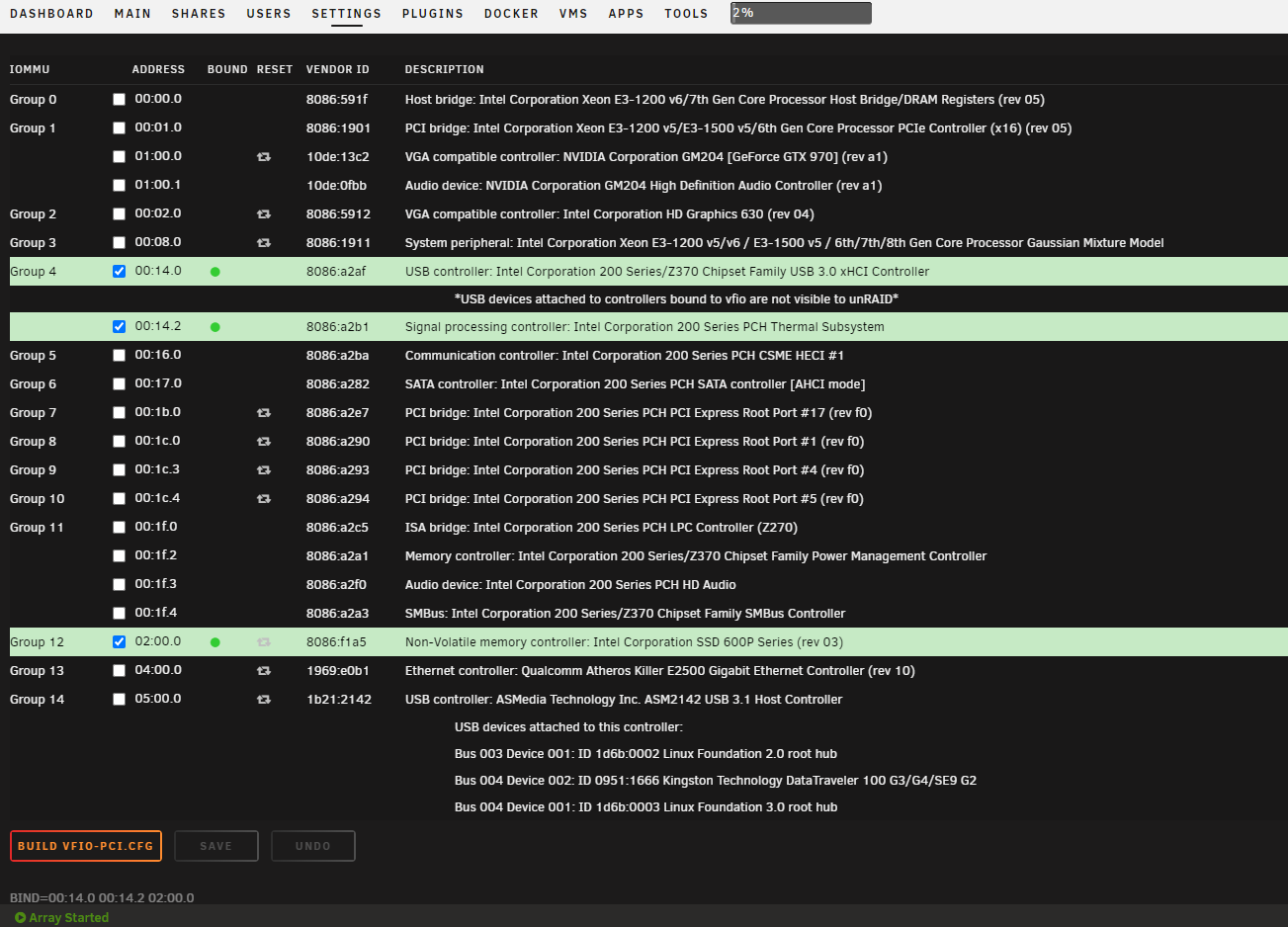

- Here is my VFIO-PCI config:

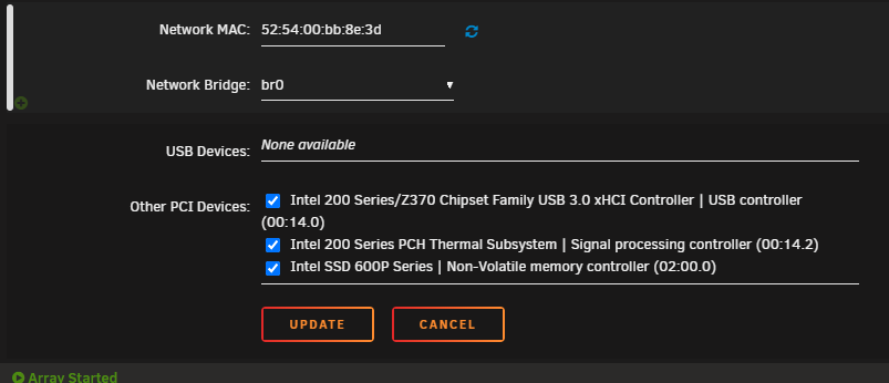

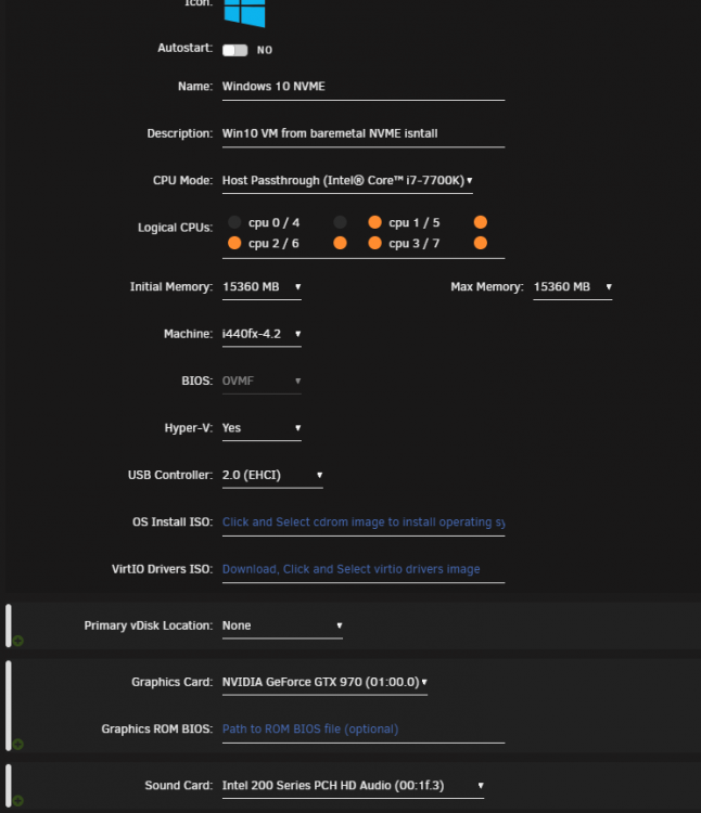

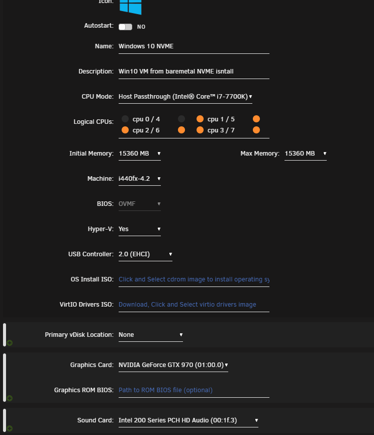

- The VM is configured with both graphics card and sound passthrough plus the NVME and the USB controller activated in other devices, here is the VM config:

Update:
After performing basic troubleshooting disabling all passthrough devices and enabling one by one I found out the sound card was preventing the VM to start.
Now with the sound card disabled the VM boots from NVME previous installation, I have video output on my monitors from my GTX 970 and all the USB devices connected  are working.
Any one knows of sound card issues from MSI's z270 mobos ?
@surferjsmc The error message explains it.
"please ensure all devices within the iommu_group are bound to their vfio bus driver"
If you wanna passthrough a device to a VM i has to be in it's own IOMMU group or you have to passthrough ALL devices from that group. You can try to apply the ACS patch in the VM-Manager-Settings and see if the groups are more separated with it.

Ok integrated sound shares IOMMU with more devices,
so enabled ACS override and tried with both downstream and multi-function and the VM crashed again, decided to go back to VFIO_PCI config and pass through the sound card but selected the SMBus controller by mistake (didn't realized until now :)) and reboot the server, then edited VM, set the sound card as usual and the VM started without any errors and sound is working now :D.
Not sure if ACS override fix it (still enable) or is because of VDIO-PCI config but is working.
