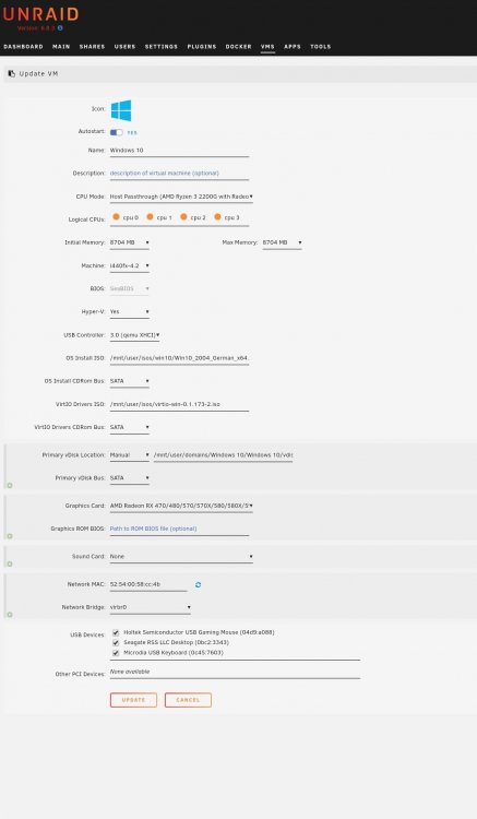

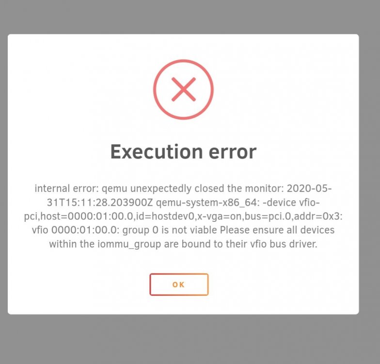

Execution erroe /I am willing to pay for someone to help me
 new to unraid
 I have submitted problem with GPU
 I always get this missing
My GPU rx570 Gigabyte
 And my XML
___________________________________

I activated sound but I always get errors

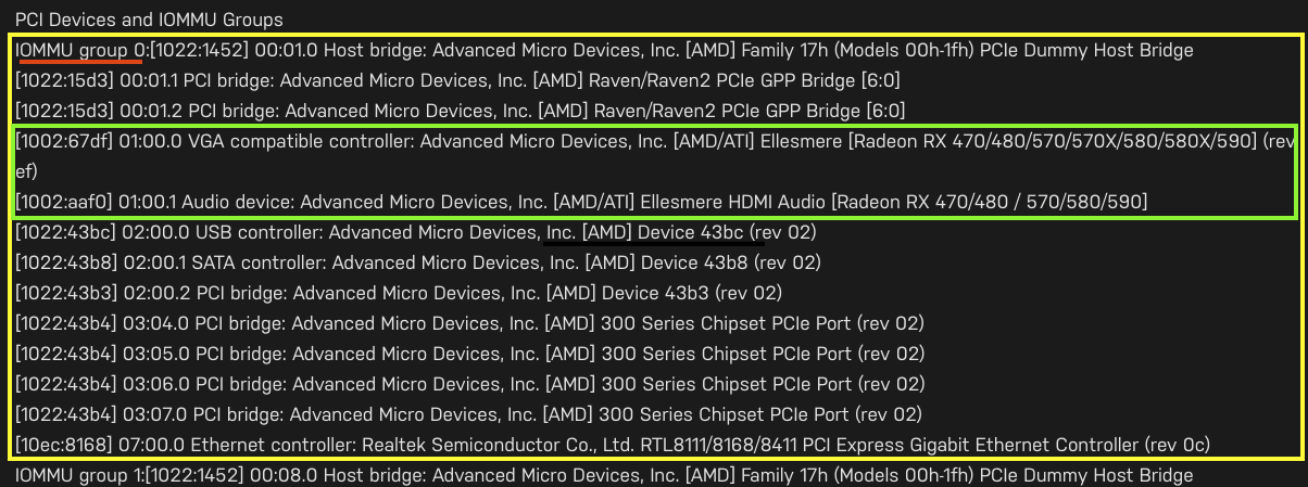

So here's your problem. Your GPU (video and audio) are stacked inside IOMMU group 0 with a bunch of other devices.
Your passthrough devices are in the green box, but, as you can see, they are in the same group (yellow box) as lots of others.
You need to switch on IOMMU in the Bios and play with the  ACS override options (Settings -> VM Manager)

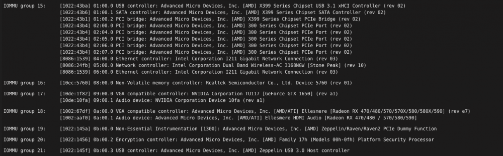

Any PCI/PCIe device you want to pass through to a VM MUST be isolated in its own IOMMU group. Here's an example from my own systems devices;
1649166402_Screenshot2020-05-31at19_21_04.thumb.png.c44afb4dd86fa37fa5ef102beb030a70.png
You can see that my Nvidia and AMD GPUs have the video and audio devices correctly paired inside discrete IOMMU groups (17 & 18). This is the kind of listing you need before you can start passing through anything to VMs.
