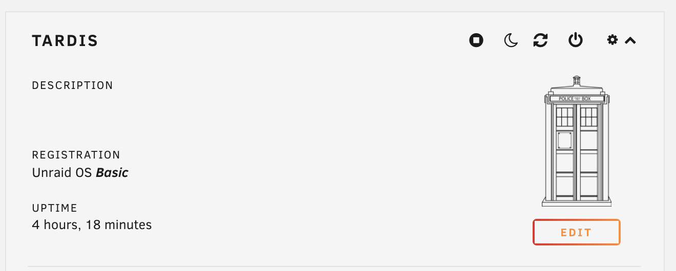

Sounds like someone has had the same idea I had a few years ago when I built my server! 🤣
709813260_Screenshot2020-06-06at20_44_22.thumb.png.8deaa72411fba61c7976177e0c8ddae1.png

The name Tardis would be more applicable if you were using a Cloud service like Team-Drives with the RCLONE plugin and scripts. The storage is larger on the inside!
