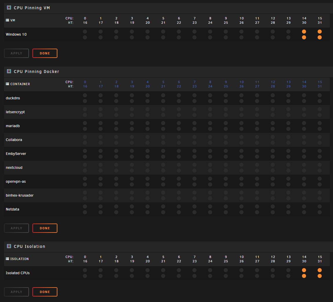

I've isolated the cores that I want the VM to use in CPU Pinning under CPU Isolation and done the restart as advised.
chrome_1kZBKZS7mo.thumb.png.0e2b59edeff865102facafc0c46e0097.pngimageproxy.php?img=&key=e5eec7c5c933ca16

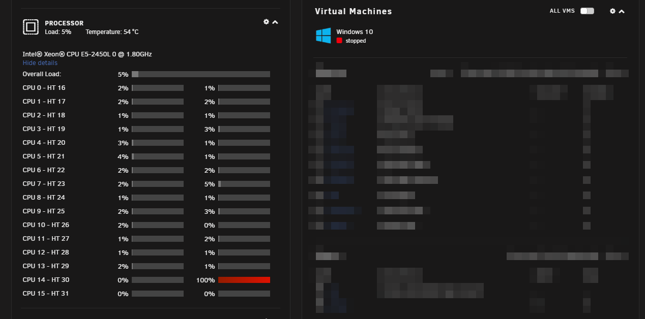

However, unRAID is still using these isolated cores when it shouldn't be touching them at all.
In fact, there's one HT that is being hammered at 100% pretty much most of the time even when the VM is no started.
Looking at this a little closer, I've narrowed the culprit down to Emby. When this is powered on and in use by someone, the core will spike.
If I stop the docker, then I see no usage on these core at all.
