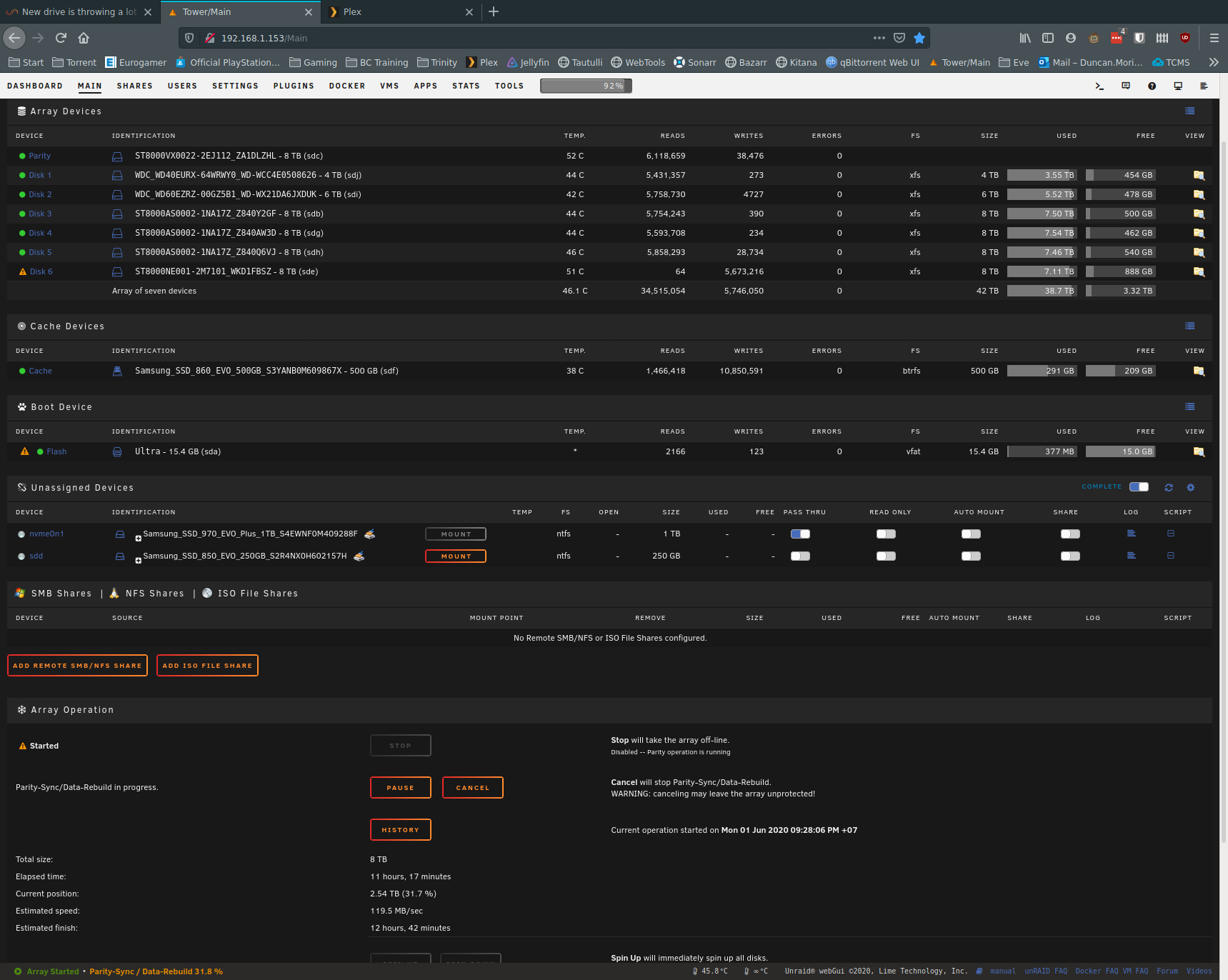

So confusing, if disk not under emulated, how come you rebuilding currently. Pls provide array status screen capture.
Edited by Benson
The files are back available since I put the drive back in and on the dashboard the drive is listed as emulated.
However, when the drive was pulled the drive was listed as not available, the amount of storage available dropped and the files on the missing drive were unavailable.
This is why I'm asking the question.... because the files on the drive became unavailable when the drive was out of the array.
Btw, observe it normal as usual rebuilding.
I never meet the said behaviour, pls wait rebuild complete.

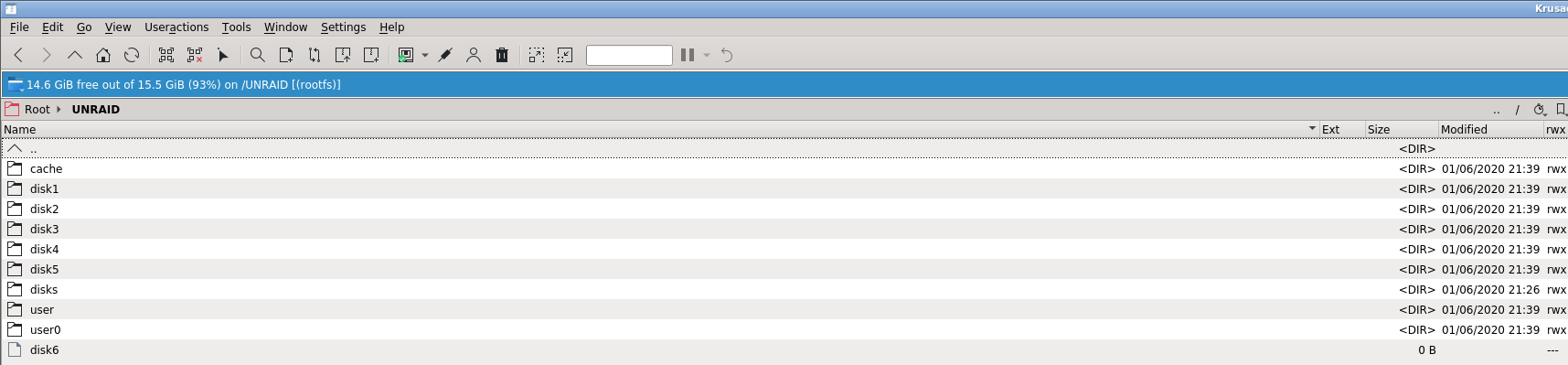

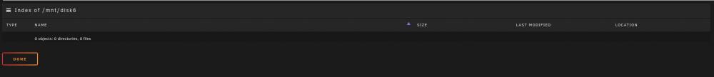

seems like I'm fucked and unRAID has lost all the data on that drive... it's failing to emulate it now:
qbittorrent also confirms that 350 torrents are errored.

NO, it started without emulating the missing drive and started chagning the parity to reflect having 5 drives immediately killing my data.
Is slot 6 the drive slot that we are talking about?  What happens if you stop the array and unassigned the disk and start the array again?
Yes.... That's exactly what I did, it decided I only had 5 drives and changed the parity drive accordingly loosing all my data.
You may need to start the array in maintenance mode with no disk assigned to that slot and then run a file system repair on that disk. You can do this by clicking the disk slot on the main tab.
yeah tried that, I'm completely fucked.
