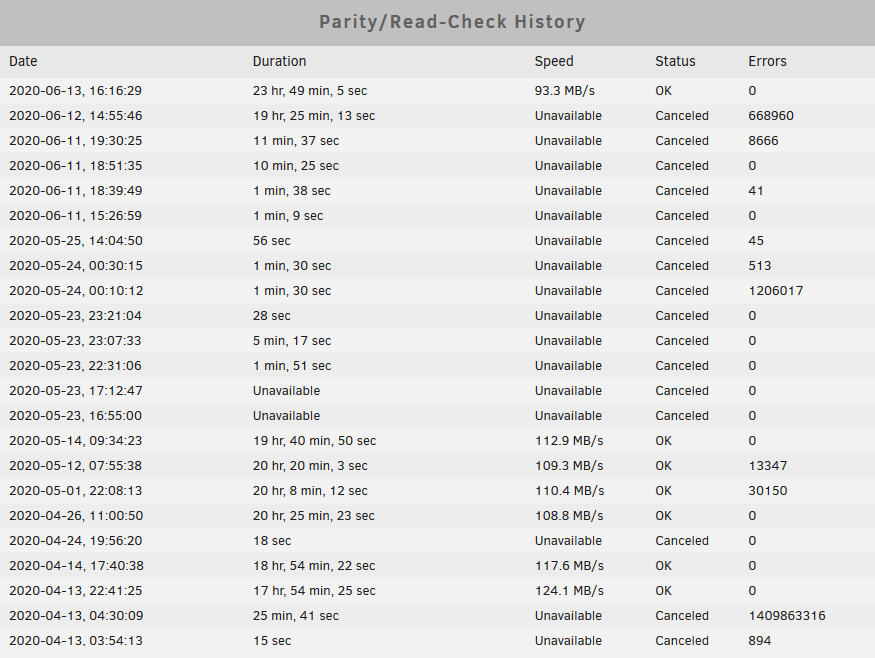

@johnnie.black I am 60.5% in to the parity check but I am at 668960 parity errors, 1182 read or drive errors in the Parity Drive, and from 8 pending sectors (from 176 before they were "fixed") it is now reporting 104 pending with 2100 reported uncorrect and 24 reallocated sectors...
Should I just remove it and start the parity on the other good 8TB drive?
all other drives have not given me any more issues...
If all the other drives are OK sounds like a good idea.

OK, Parity Rebuild finished successfully, everything is good now, thanks for the help, will be changing some cables and changing a sata power splitter too just in case. afraid to even touch it now.... but I do have some upgrades waiting for it...

I wanted to follow up and get your opinion... I just finished a Parity Check and It found 8345 errors, should I rerun parity and fix the errors or what should I do? I haven't changed anything physically since the last post about the parity write finishing.
nas-diagnostics-20200620-2013.zip
