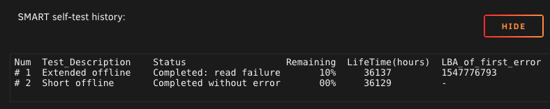

My monthly parity check just ran, and came up with some errors for my Parity Disk 2:
Self-test history:

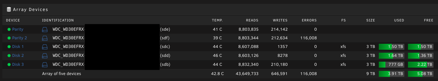

Well, not looking good... Parity check slowed to a crawl at 93.4%, with 12 days estimated left to go at 233 KB/s. Parity Disk 2 is now up to 526k ERRORS.
Edited by Phoenix Down
Well, I stopped the parity check just before Parity Disk 2 hit 800k ERRORS. Looks like it is toast :( Going to swap it out.
SMART test failed so that drive needs to be replaced.
