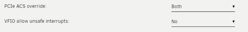

June 6, 20206 yr Author Thank you Stu , I managed to break up the IOMMU with the ARCS override on the motherboard and spend hours watching Space Invader . Cheers for the reply

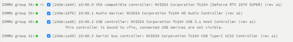

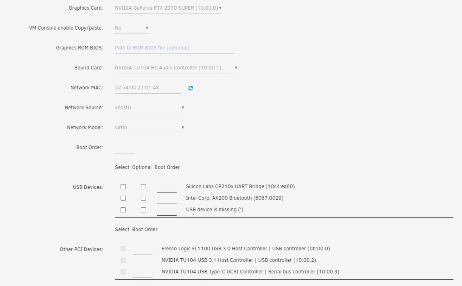

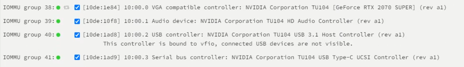

September 16, 20242 yr having to redo a VM with a 2070 i'm here to clarify the things needed: Lattest Unraid verion 6.12 Step 1 PCI Bind: I'm using VM overids your IOMMU groups may vary. You must pcie bind and pass the VGA, Audio, USB and Serial Devices of the 2070... Step 2 xml edits for multifunction: <hostdev mode='subsystem' type='pci' managed='yes'> <driver name='vfio'/> <source> <address domain='0x0000' bus='0x10' slot='0x00' function='0x0' multifunction='on'/> </source> <alias name='hostdev0'/> <address type='pci' domain='0x0000' bus='0x03' slot='0x00' function='0x0' multifunction='on'/> </hostdev> <hostdev mode='subsystem' type='pci' managed='yes'> <driver name='vfio'/> <source> <address domain='0x0000' bus='0x10' slot='0x00' function='0x1'/> </source> <alias name='hostdev1'/> <address type='pci' domain='0x0000' bus='0x03' slot='0x00' function='0x1'/> </hostdev> <hostdev mode='subsystem' type='pci' managed='yes'> <driver name='vfio'/> <source> <address domain='0x0000' bus='0x10' slot='0x00' function='0x2'/> </source> <alias name='hostdev2'/> <address type='pci' domain='0x0000' bus='0x03' slot='0x00' function='0x2'/> </hostdev> <hostdev mode='subsystem' type='pci' managed='yes'> <driver name='vfio'/> <source> <address domain='0x0000' bus='0x10' slot='0x00' function='0x3'/> </source> <alias name='hostdev3'/> <address type='pci' domain='0x0000' bus='0x03' slot='0x00' function='0x3'/> </hostdev> Note that by G-card is in pcie slot 10 Note the multifunction option is on, that all devices on in virtual pcie slot 3 with their function matching the virtual function. This is required to pass a 2070/2080 nvdia gcard i'm also using machine type q7.2 with uefi(OVM) Please review: other edits see Edited September 16, 20242 yr by bmartino1 fix xml mistake
