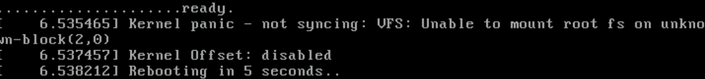

I tried Seabios and changed the lines in XML. But when I start the vm there is a kernel panic error
You can close this request.
The qcow2 worked, but the Kernel Panic error is from the VM inside, not from unRAID.
