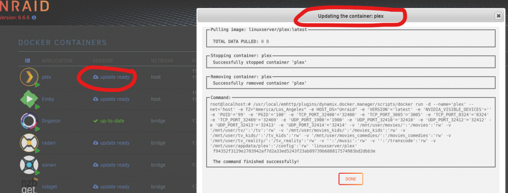

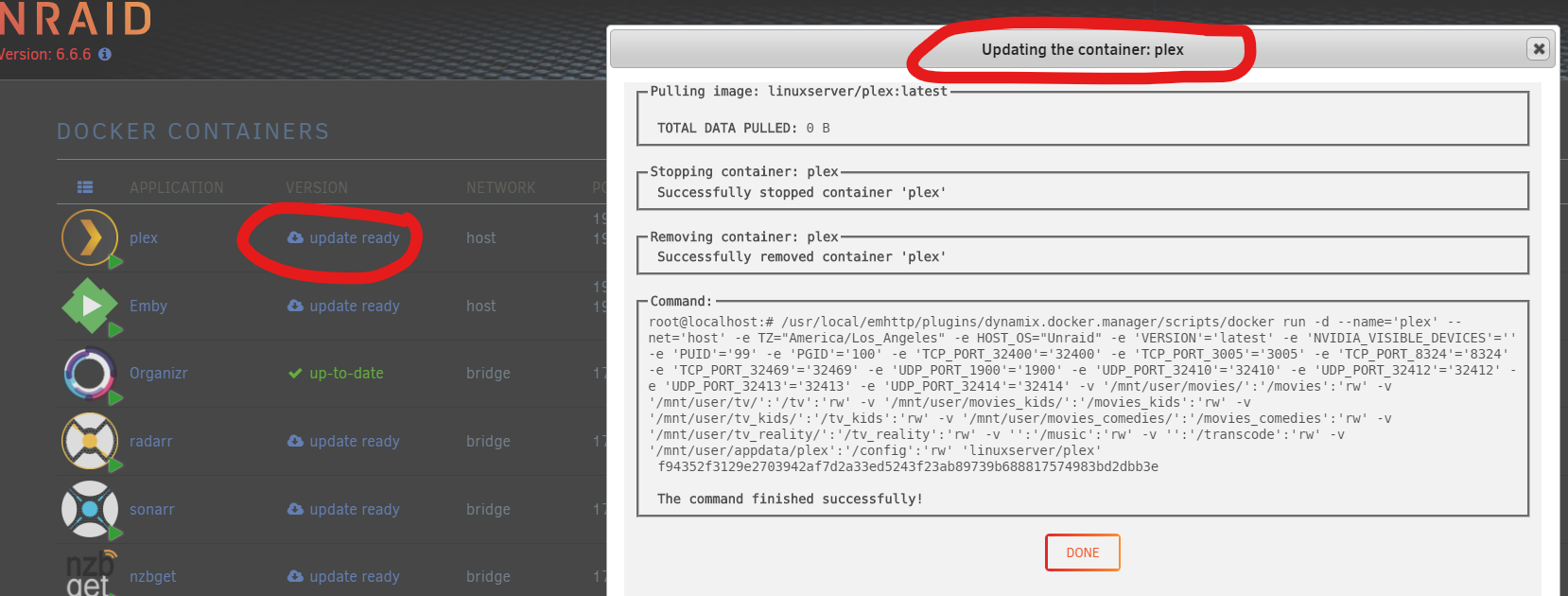

The reason for me needing to update is whenever I try to update a docker that has an 'Update Ready', I receive Data Pulled 0B and nothing downloads which keeps me stuck at the current docker versions I have installed as well as unable to download any new Community Apps.
These sound like a problem with your server being able to access the internet. No matter which version you are running if your server can't access the internet, and get reliable DNS lookups, these things will not work.
No, once I updated to 6.8.3 I could not access the server inside my LAN via IP. After loading up the GUI on the local machine, Firefox told me it could not connect to the internet. However after reverting back to 6.6.6 the local machine GUI booted firefox right up into the dashboard.
The server has been able to reach the internet fine for the past year and still can. I am able to use dockers that look out to the internet as well as find community applications. They just wont download updates or download new dockers

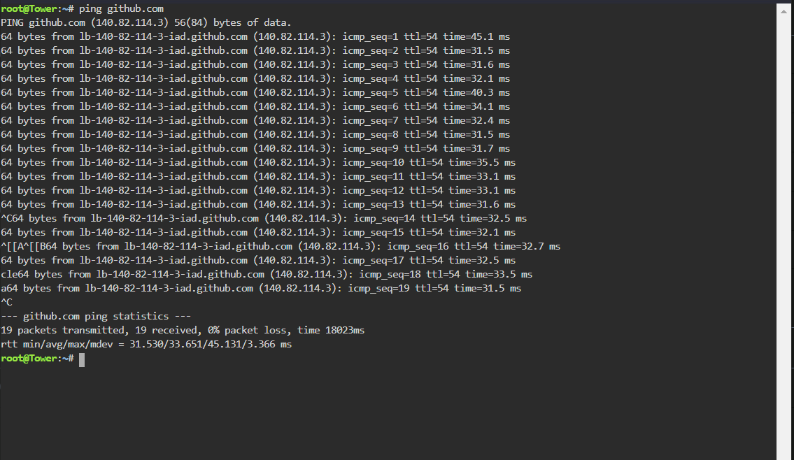

Can you ping github.com for example?
Looks good to me
