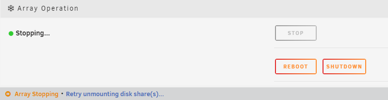

Retry unmounting disk share(s)
Hi
I've just clicked to update Plex on Docker and it downloaded the update and took ages to install. I thought I'd just close the box and let it do it in the background but it's still going 15 minutes later and it's blocking access to the GUI with the unRAID wavy loading icon in the centre of the screen and there must be a div covering the whole screen as no buttons are clickable. When I go back to the IP of my server again I can access stuff but as soon as I go to Apps I get completely bricked again. Docker tab shows the loading graphic too and doesn't load in Plex again.
Edit: This has since morphed into another issue (hence updated thread title Retry unmounting disk share(s)).
Edited by Dal1980
Updated thread title due to change of situation
I tried stopping the array so I could just try a restart but I'm getting problems doing that too

Jun  7 23:06:06 borg emhttpd: Unmounting disks...
Jun  7 23:06:06 borg emhttpd: shcmd (6094): umount /mnt/cache
Jun  7 23:06:06 borg root: umount: /mnt/cache: target is busy.
Jun  7 23:06:06 borg emhttpd: shcmd (6094): exit status: 32
Jun  7 23:06:06 borg emhttpd: Retry unmounting disk share(s)...
I don't know what to do at this point
Should I just hit Reboot?
It's been 4 hours.
Strangely the apps tab now works but I'm still getting the Retry unmounting disk share(s) message. Is this safe to reboot or is there a console command I should use to stop this array before rebooting?

Have you been able to resolve this? I'm seeing the same non-shutdown because of trying to remount disk shares.  I also have had Plex docker running while seeing this.
Hi JDGJr
I might have deleted the container and setup Plex again. I don't think it effects anything as long as the same directories are used since that's where all the settings/media files are kept. It seemed that the update knocked out something in the instance. I also restarted the server before I deleted the container and after I think if I remember correctly.
Hope this helps
