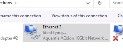

Short story: I have an ASRock x570 motherboard that has an on board Aquantia Aqtion 10Gbit network adapter. I've successfully passed through the adapter card to the VM (leaving the other onboard adapter for Unraid). If I reboot Unraid and then start the VM, the adapter in Windows gets an IP address via DHCP and the connection remains stable and I am happy. However, if I stop the VM [nicely] and then restart it, then the adapter doesn't pick up an IP address and its status fluctuates between the three states below. Nothing I've tried other than rebooting Unraid seems to solve the issue.
Identifying -> Network cable unplugged -> Enabled -> ... repeat ...
