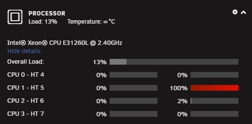

As an aside I've noticed this morning that my CPU usage is showing as 100% as shown in the following pic - one minute it was CPU3 in the left column and then next it has changed to CPU1 in the right hand column?? (I've not noticed any of the CPU cores registering 100% before?)

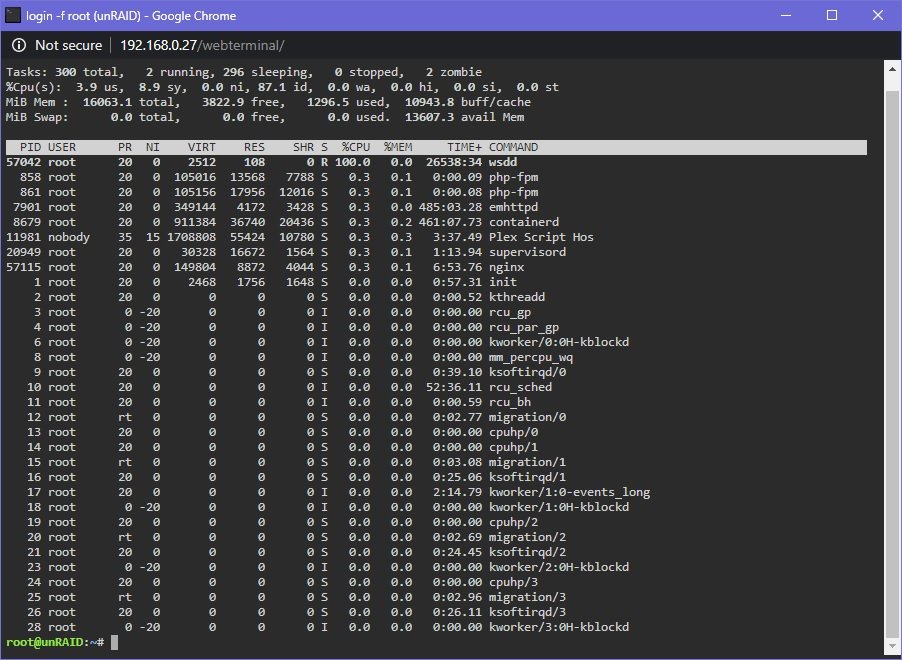

Your 1 core 100% is probably WSSD going wild, you can verify with the 'top' command

Sorry (again) for being thick but what is "WSSD" and how to I verify with the "top" command? (and verify what exactly?) - it's still doing it by the way, but right now it's the 2nd column on CPU3 for some reason!)

Log into the command line and run the command: top
it will list all the processes running, by order of which is consuming the most CPU - press Q to quit

Regards the CPU usage, you really have to understand how low my knowledge base is here - I'm very much a GUI person, I wouldn't know how to even log into the command line? Do you mean physically use a keyboard attached to the server or is this something I can do within the UI?
Click this in the top right to get to the terminal
From there, type: top
Note what's at the top of the list, then press Q to quit, then u can close the terminal with: exit

Ran the command and it does indeed look like WSDD - whatever that is? Is it something I need to be worrying about or stopping somehow?
You can disable it in SMB settings, discovery will stop working for Windows 10 clients tho (the server won't show up under network, you can still reach it by name/IP)
