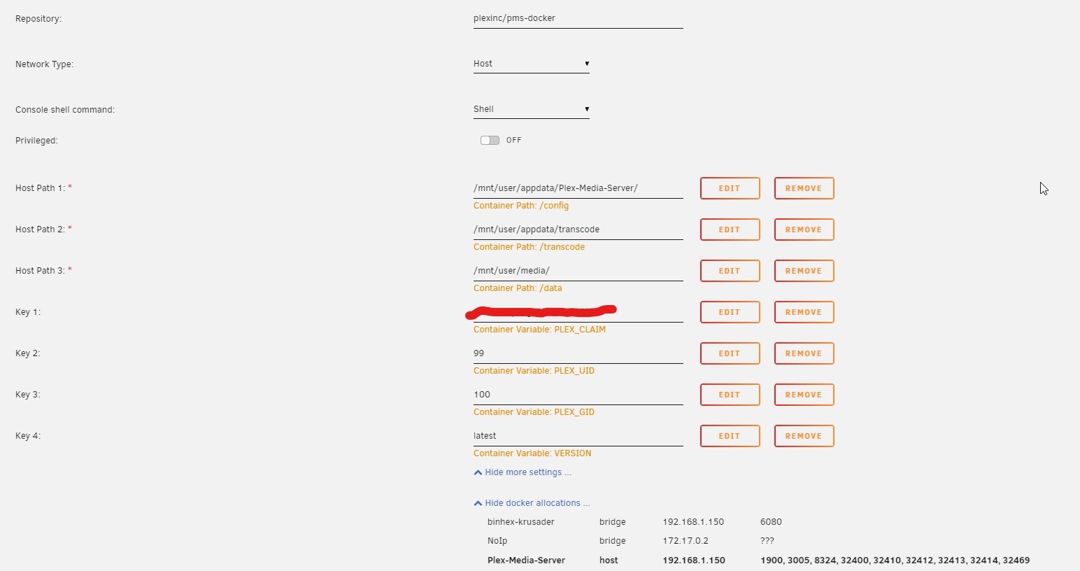

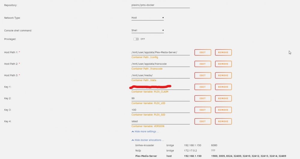

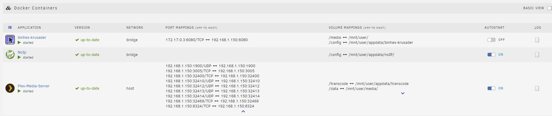

I've narrowed it down to the dockers causing the IP conflict after some time. My hunch is that it is Plex causing it, but I have no idea why.
I have Plex, krusader, and noIP installed as dockers. The raid and the dockers work fine for a day or so, and then (usually in the morning), we discover that we have no internet throughout the house and I have to power down the unraid box to fix it. At the moment, the unraid box is set as dhcp in network settings. I have assigned the unraid box to a specific reserved IP address in my router.
I have tried the following:
  1. setting unraid with a static IP in unraid network settings and the assigned IP is outside of my router DHCP range.
  2. unraid with a dynamic IP in unraid network settings and then updating my router settings with a reserved IP address for the unraid box via the unraid mac address.
Attached are screenshots of my docker setups. As a test, I will disable all dockers for a few days and see what occurs. If the network remains up, I will then enable 1 docker and then see what happens after a couple of days. Then repeat, enabling the other 2 dockers I have.
I will reply back with updates on the testing, but if anyone has any ideas why the docker(s) would cause this, that would be greatly appreciated.EoGZkuY4TW.thumb.jpg.a4902cd9f0d2da7162a5de78ffb8e94a.jpgInkedJnSCBKFJqi_LI.thumb.jpg.fea09b84e339ab731fbdb6e6d80721df.jpg
If you change network type to bridge it wont do that as it will be natted behind a private range.
But then I can't access the Plex web gui.
You can in the same way you access your crusader docker. There is a nat mapping similar to that.
Got it, I think. Changed Plex docker to Bridge, then setup new container ports for all of the Plex required ports. I can access the web gui now, but access from mobile device with Plex app and also from streaming devices (EG: Roku on TVs) seems slower. Sometimes receive the "Not directly connected to server" message.
Maybe you need a static route on your gateway to accommodate. You can ask in the plex docker thread about that.
