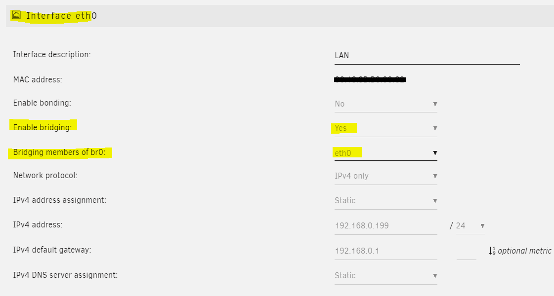

January 29, 20215 yr From your screenshot I see that you have indeed NO 'br0' network. That's the reason why the VM fails. WHY you don't have no 'br0' is the other question... Â my network looks like this:Â Â

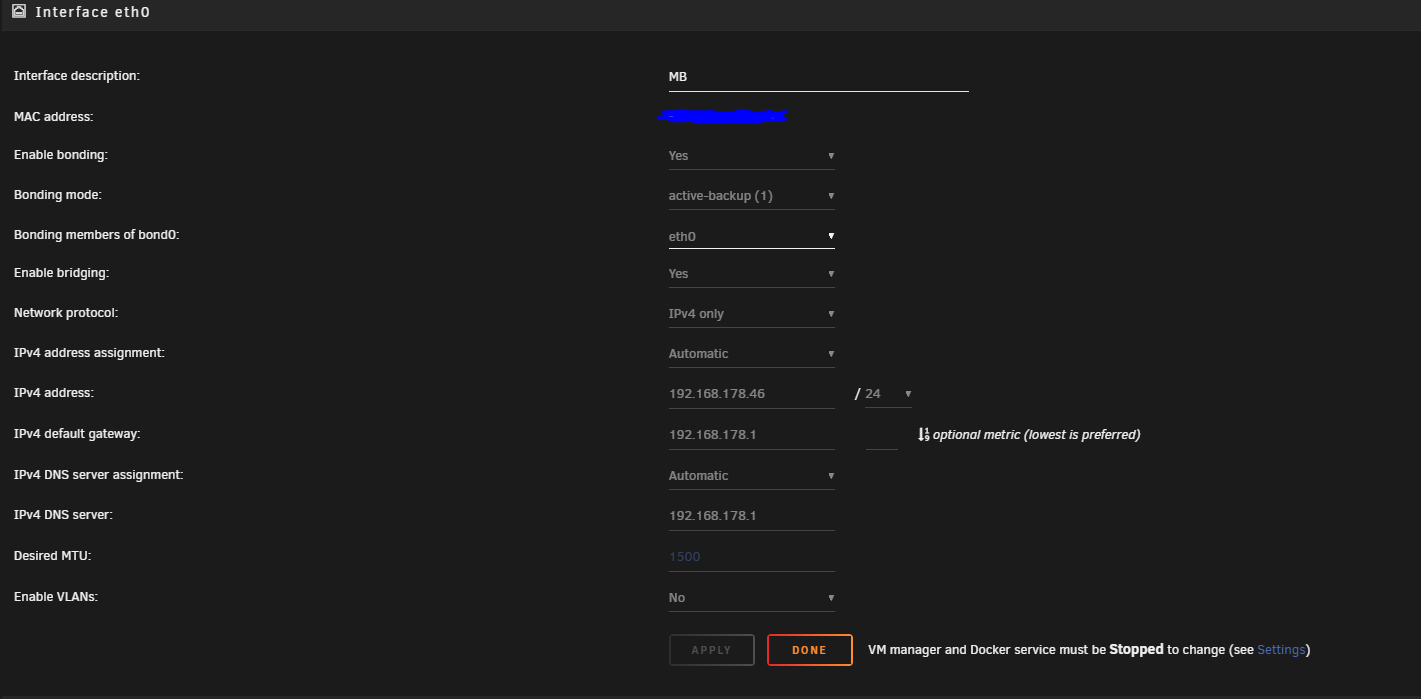

January 29, 20215 yr hmm... you could try to disable "bonding" by setting "enable bonding" to "no" - because you only have one bonding-member (eth0) - so there is no benefit in enable bonding?! Â i just saw it - you don't have the "bridging members" - certainly because of enabled "bonding" ... i really would try that! Â ...maybe this makes a difference?! and after that a reboot... Edited January 29, 20215 yr by sturmstar
January 29, 20215 yr 3 hours ago, sturmstar said: hmm... you could try to disable "bonding" by setting "enable bonding" to "no" - because you only have one bonding-member (eth0) - so there is no benefit in enable bonding?! Â i just saw it - you don't have the "bridging members" - certainly because of enabled "bonding" ... i really would try that! Â ...maybe this makes a difference?! and after that a reboot... Thank you very much! The system is running again.
