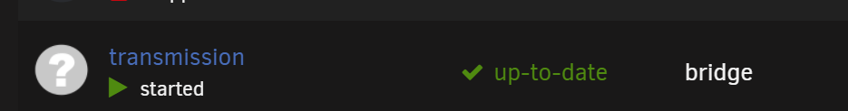

also i find that the Transmission  Icon goes away as an orphane but it has come back once i shut down a VMetc

so i not sure whats causing it..  the orphane pic is transmission isnt even running but i noticed  if i shut off a VM  the image usually comes back and then Docker will speed up  but it will go back to sleep later

and still Transmission  os orphaned  and doesnt work even though  its running...    when you click webugui.. its working just not downloading..

also the Transmission  Icon came back..  and no longer and orphane image..  and once that happened   Docker loads in 1 second..  but it took a day after me setting vms  appdata etc  to Cache Only
