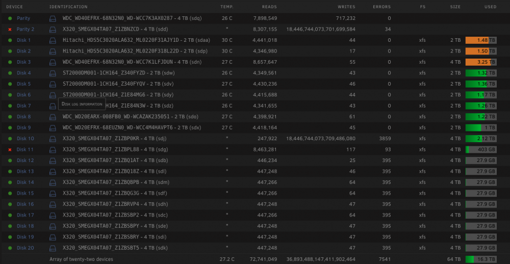

It appears as though what ever disk Unraid is writing to, that drive is eventually just disable itself.
Below is a picture of all my drives, Disk 10 to 20 + ma parity 2 Drive on running off a NetApp Shelf with a controller card. the rest of the Disks are internal disk running off of 2 old IBM SAS cards.
I always have the same issue with my netapp shelf.
Before Disk 10 was "full" Unraid was writing new data to it and it keep Disabling itself.
now that it's writing to Disk 11, it's now the one Disabling itself.
Parity 2 seems to follow along the ride each time.
What's causing this?
What I do to get everything back online, is turn off the array, remove the drive and then rebuild it. then turn off the array a 2nd time, and remove the 2nd parity drive and rebuild it again. that take like 4 days.

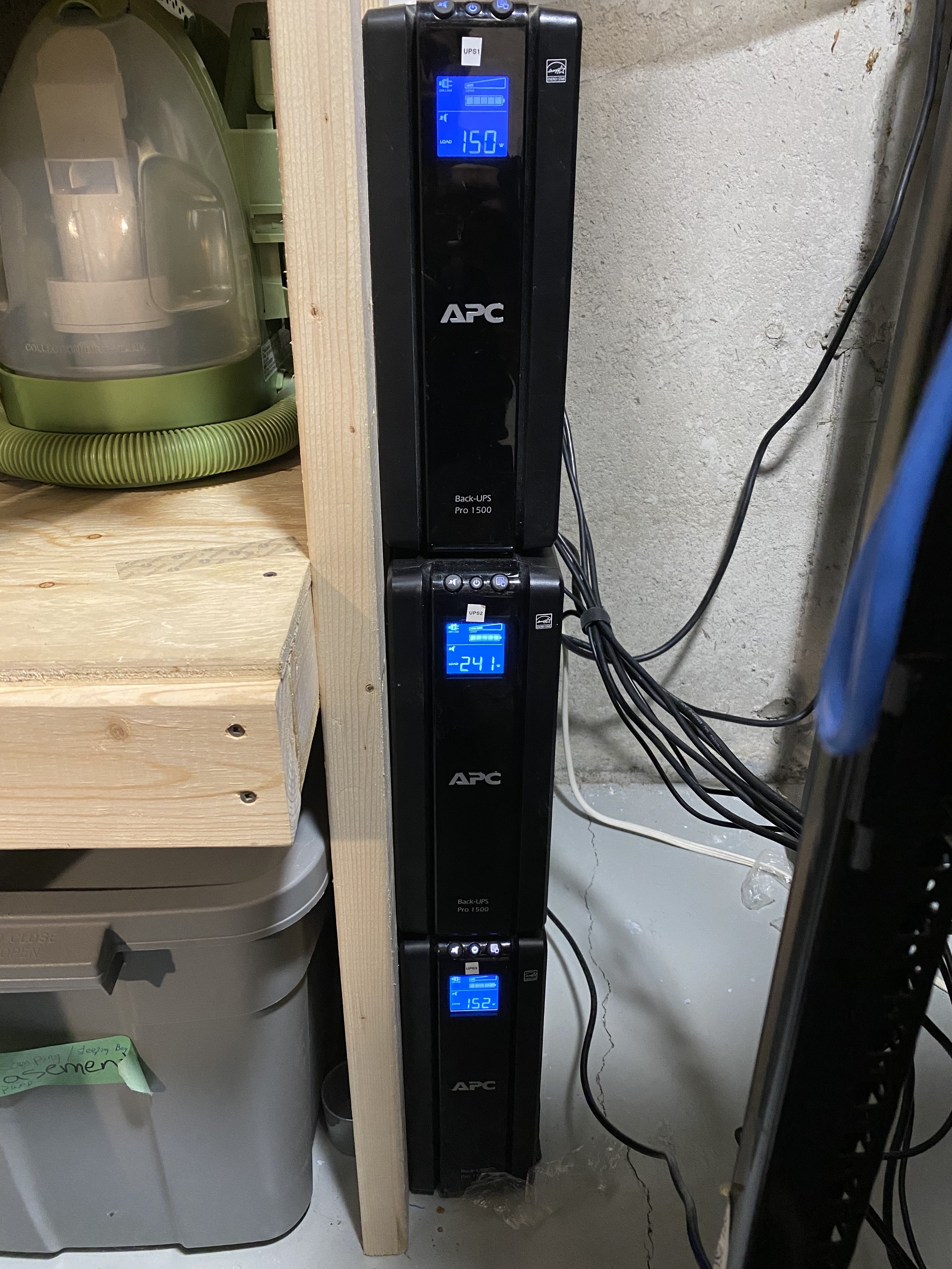

My closer look, Are you certain you have everything on a UPS? Right after your UPS did a self test your disks dropped offline and could not be read from.

2. Yes, everything is on UPS, my Shelf is on 1, and my Unraid server is on a different one.
my NetApp has 4 power supplies, I only have 1 plugged in. (I'm only using 1 half of the shelf)
I'll try plugging the 2nd PS to my 3rd UPS.

But notice how i'm getting errors on all my NetApp drives?
(Theses are actually brand new drives, never used, sat a powered off shelve for 4 years then moved to storage for 1)
That is not a disk problem, Unraid is losing connection with the entire NetApp enclosure.
I think you said the disk enclosure is on a separate UPS from Unraid. That can be an issue.
To troubleshoot, move all interconnected disk equipment to the same UPS and see what happens.
