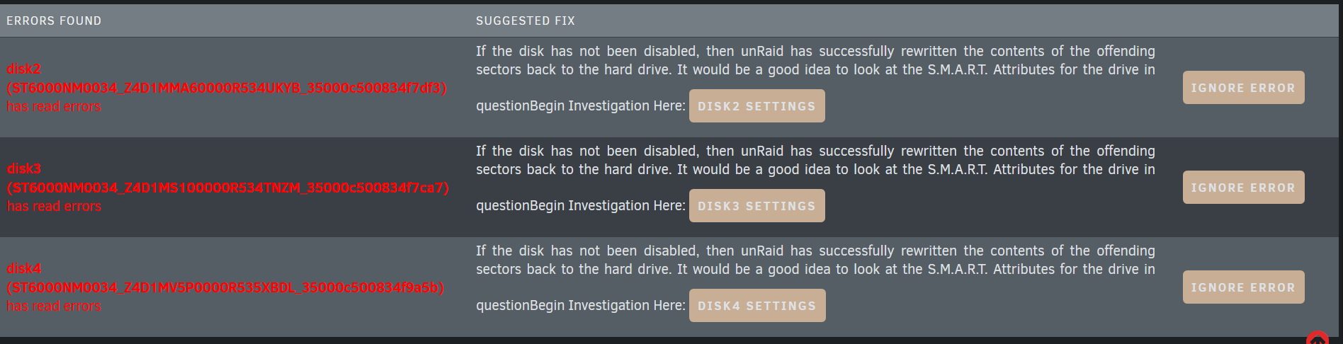

Having disk errors in fix common problems after moving to new hardware. I went from an R710 to an R720xd.
The SMART errors are the following (even though everything in the GUI says healthy

Additional thing to note, I’m getting tons of errors on the main page, but everything seems to be working fine.
