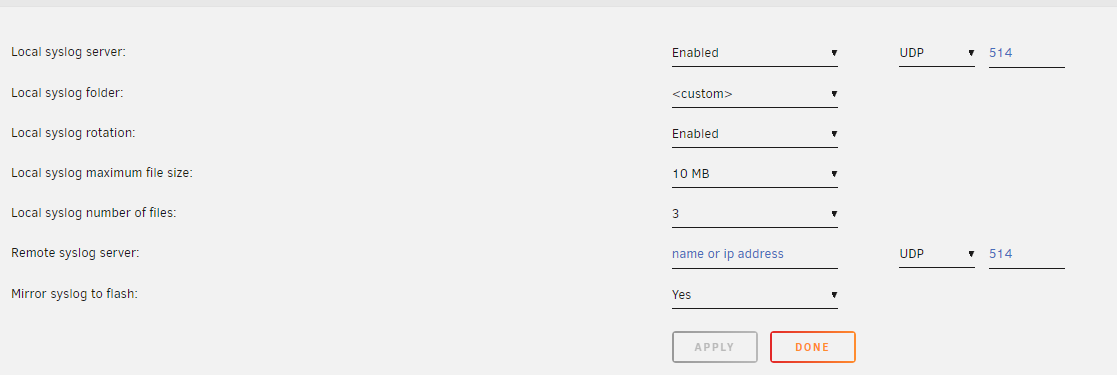

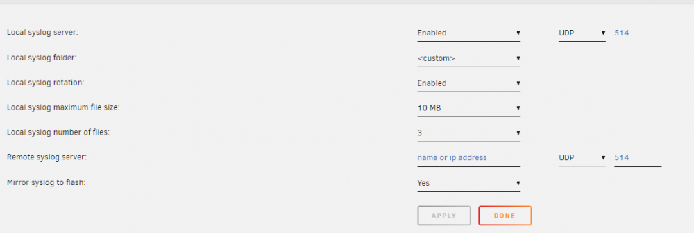

no the syslog was running and saving to the flash drive.  as it set it to Mirror to Flash
Only need to post it after the server crashes, not much point in looking at it before that.
@johnnie.black this is a pre crash syslog.image.thumb.png.f4e0983b7b3c90dcebb2d7488a8ea36a.png
