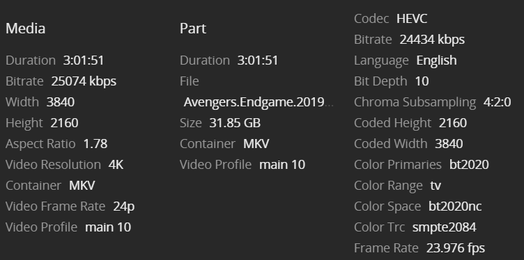

Media file details:

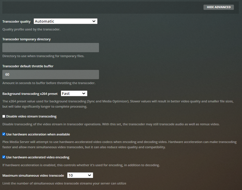

Plex Transcode Setting:

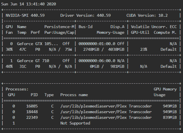

At 2 steams, everything looks OK:

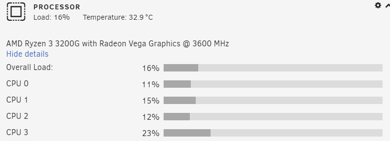

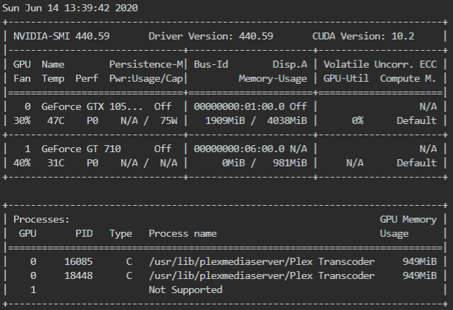

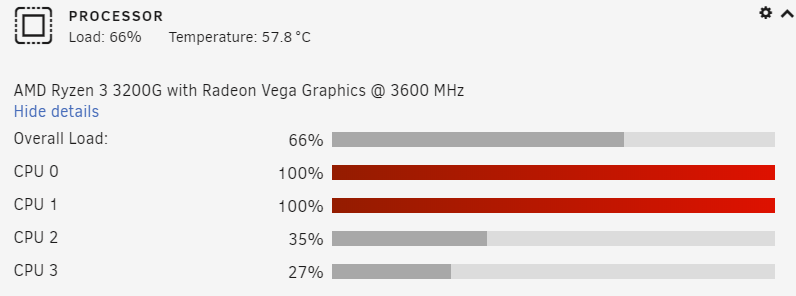

However, at 3 streams the CPU usages gets heavy (70-90%), despite 'nvidia-smi' reporting GPU transcoding. No issues on client playback.

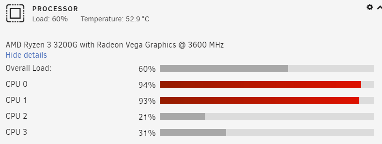

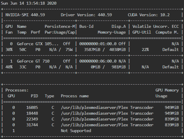

At 4 streams, CPU usage is pegged at 100% and the 4th stream experiences intermittent playback:

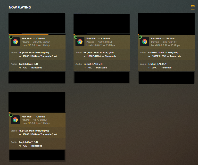

Here is plex "now playing" at 4 streams:

-Despite all 4 streams being exactly the same movie streamed to the same device at the same settings, the last two are only 839MB of GPU memory compared to the first two at 949MB.
-GPU memory does not appear to be a constraint (3587/4038).
-Same issue occurs when using various clients around the house (laptops, iphones, ipads, etc..)

-Docker tab correlates binhex-plex cpu usage.
Conclusion:
Although it appears that the GPU is doing the job of plex transcoding, there is still a CPU penalty incurred.

By itself, this would not account for the CPU usage you are seeing, but, any audio transcoding or subtitles is handled by the CPU and not the GPU
It is not clear if audio transcoding/subtitles are involved in your scenario.
By the way, as a general observation, it is recommended to keep CPU 0 and its associated thread available for use by unRAID for core NAS functions and system overhead.  unRAID can sometimes suffer performance wise if CPU 0 is not available.

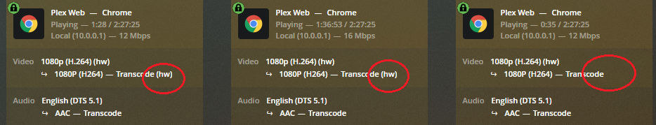

It appears that only the first stream is being fully transcoded in hardware (both decode and encode). The second two are being decoded in hardware but encoded in software. I'm not familiar with using Plex hardware transcoding on Nvidia cards so I'm not sure if they are capable of encoding multiple streams simultaneously like I know my Intel Quick Sync can.
Actually, I stand corrected. I ignored the last, fourth one. The first and last are being both decoded and encoded in hardware. The middle two are only being decoded in hardware.
Yes good eye I didn't notice the last two streams that appeared in the "now playing" didn't have a "(hw)" on the playback. This correlates with the sudden jump in cpu usage from the 2nd to the 3rd stream and the difference in GPU memory utilization (839 vs 949MB) for the last two streams.
(BTW plex doesn't order the "now playing" list chronologically, so it was in fact the last two streams that didn't have (hw) encoding)
So what's the limitation here? Is it hardware or software? Why won't the GPU take on a 3rd or 4th encoding task, despite doing the decoding just fine.

3 hours ago, bigbangus said:
Really curious if any other Unraid Nvidia / binhex-plex users have this same issue, ie 3rd stream and on doesn't use gpu for encoding.
Because typical gamer type nvidia cards are limited by the manufacturer to 2 streams. To decode more simultaneous streams, you need one of the pro level cards that sell for more money.
Thank you for clarifying this is expected behavior. I'll have to go pro if need more streams handled by the GPU.
