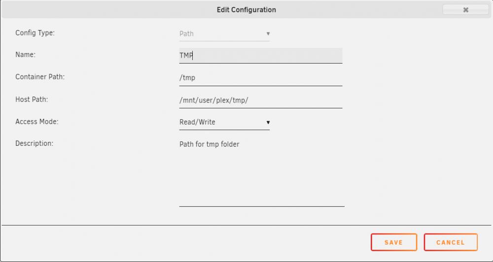

One of my previous posts may be related... I am not using any GPU's nor am I using RAMDISK however, it sounds like the same issue you are having with the tmp dir. I created a share like the following
plex
=> transcode
=> tmp
Post:

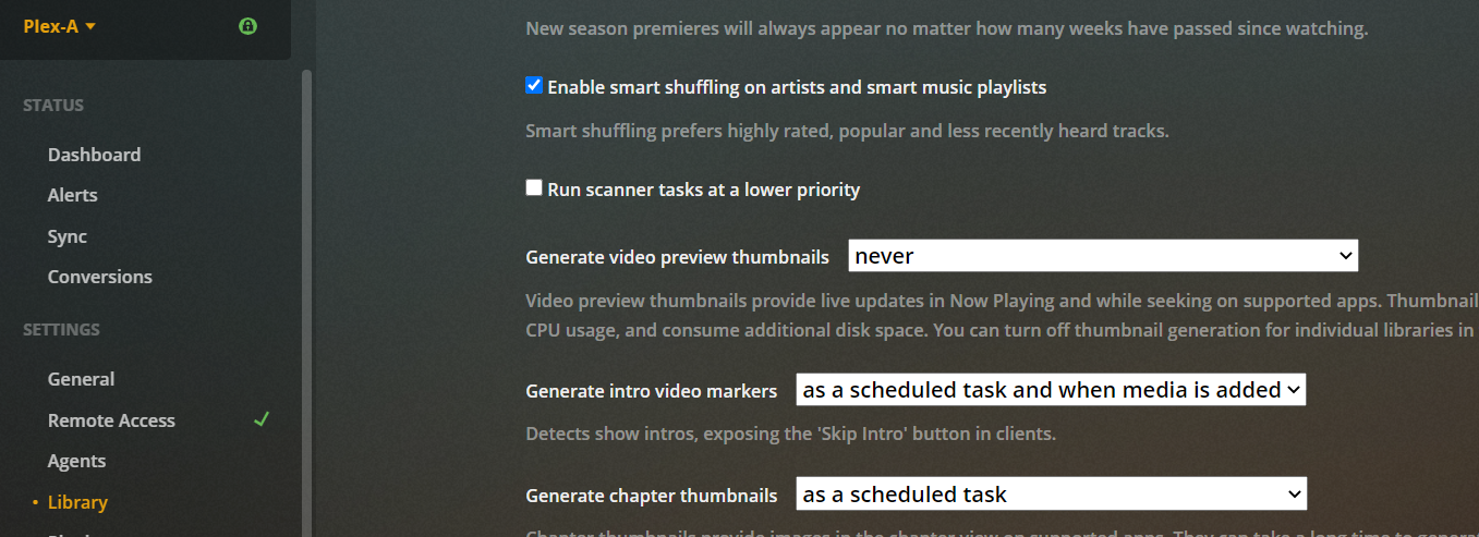

I too have been having issues as of late. Plex sits arounf 423mb used then spikes to 7.4G then 14G, etc. I found that the /tmp dir was the culprit.
I found an article that states the developers are aware of it and is related to the recent  "Skip Intro” feature. That being said, it mentioned setting the following setting to never: (Settings - Server - Library - ‘Generate intro video markers’ set to “never” until this issue is fixed. I didn't set mine to never, rather i added an additional Path (below).
I also created an additional Path to /tmp that resides outside of the docker image, see below for my settings. I believe this will only need to be done temporarily until the real issue is resolved.
-MW
very interesting...I have tried to mount the transcode folder to the array but the problem still occurs and the drive heats up to almost 150F.  I do in fact have generate intro video markers turned on and I do know that Plex recently rolled that feature out so that could very well be the case.  I'm going to disable that and see how it behaves.
