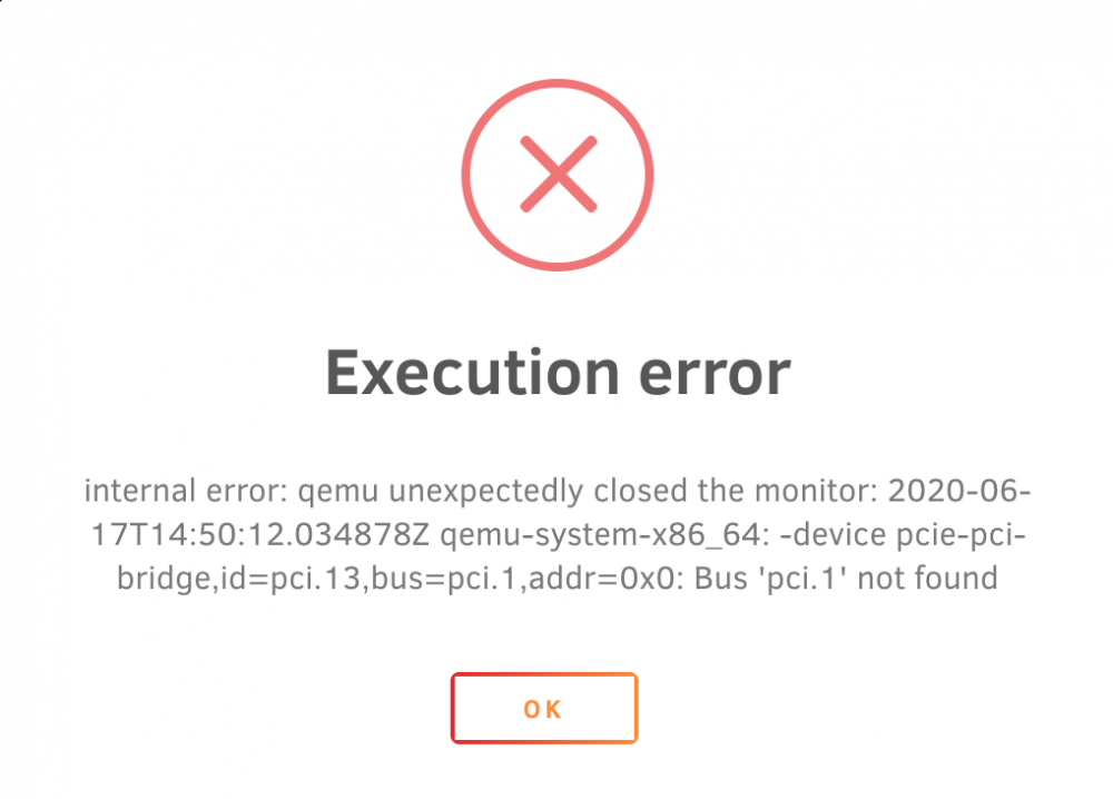

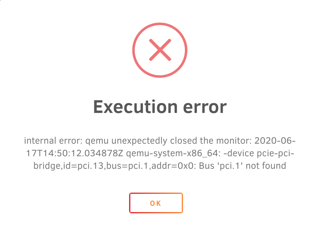

In case it is of any use, attached is the PCI error I get each time I remove all passthrough devices, save the VM config, then add back in any passthrough device (video card or USB or both). The first power on will fail with this error or something very similar, device IDs might change, subsequent power on attempts will work perfectly fine.
