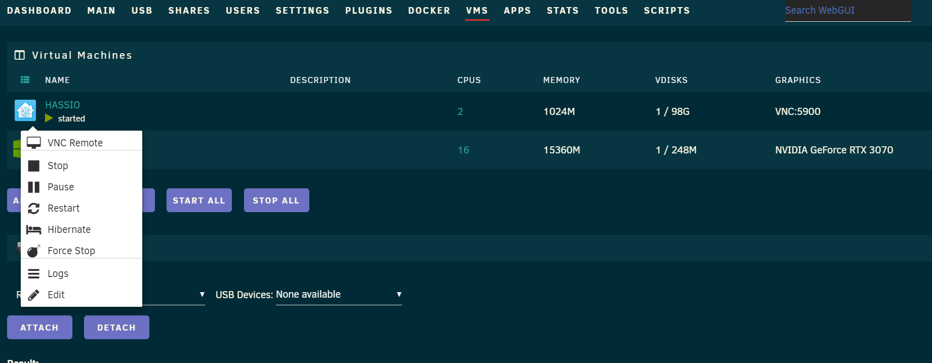

June 16, 20215 yr 1 minute ago, k0vw said: Please see the attached screenshot. Sorry how would i access the log files? For system log go to tools and system log. For the log of the VM click inthe icon of the vm and logs
June 16, 20215 yr 1 minute ago, rachid596 said: For system log go to tools and system log. For the log of the VM click inthe icon of the vm and logs Yeah sorry I cant click on the VM logs. The system just begins to freeze and pins all CPU cores to 100%. I just tried to start the VM to see if i could see the logs so this system log is quite short. opti-syslog-20210616-0852.zip
June 16, 20215 yr 3 minutes ago, k0vw said: Yeah sorry I cant click on the VM logs. The system just begins to freeze and pins all CPU cores to 100%. I just tried to start the VM to see if i could see the logs so this system log is quite short. do you edit anything here?

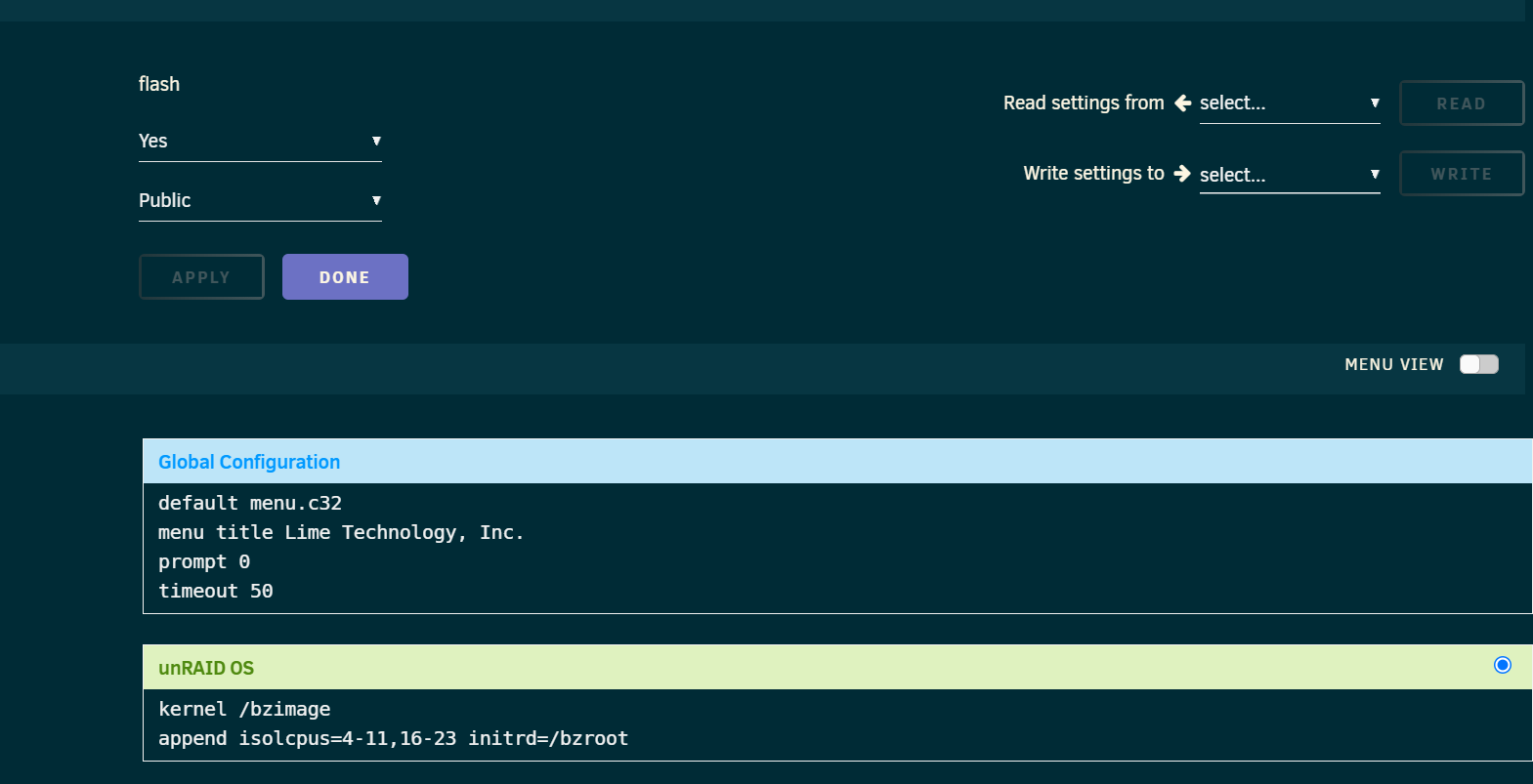

June 16, 20215 yr Just now, k0vw said: Yes i've added append pcie_no_flr=1022:1485,1022:1486,1022:149c,1022:1487 vfio-pci.ids=1022:1485,1022:1486,1022:149c,1022:1487 delete this pcie_no_flr=1022:1485,1022:1486,1022:149c,1022:1487 vfio-pci.ids=1022:1485,1022:1486,1022:149c,1022:1487 and in tick what you want in tools system devices
June 16, 20215 yr 1 minute ago, rachid596 said: delete this pcie_no_flr=1022:1485,1022:1486,1022:149c,1022:1487 vfio-pci.ids=1022:1485,1022:1486,1022:149c,1022:1487 and in tick what you want in tools system devices Done. The ones ticked in the system devices are still the same. Rebooted the system and tried to start the VM. Same issue. I did go to the logs right away and saw this Jun 16 19:05:44 Opti kernel: clocksource: Switched to clocksource hpet Jun 16 19:05:55 Opti kernel: vfio-pci 0000:2e:00.0: not ready 1023ms after FLR; waiting Jun 16 19:05:58 Opti kernel: vfio-pci 0000:2e:00.0: not ready 2047ms after FLR; waiting Jun 16 19:06:01 Opti kernel: vfio-pci 0000:2e:00.0: not ready 4095ms after FLR; waiting Jun 16 19:06:06 Opti kernel: vfio-pci 0000:2e:00.0: not ready 8191ms after FLR; waiting Had to reboot the server again opti-syslog-20210616-0907.zip

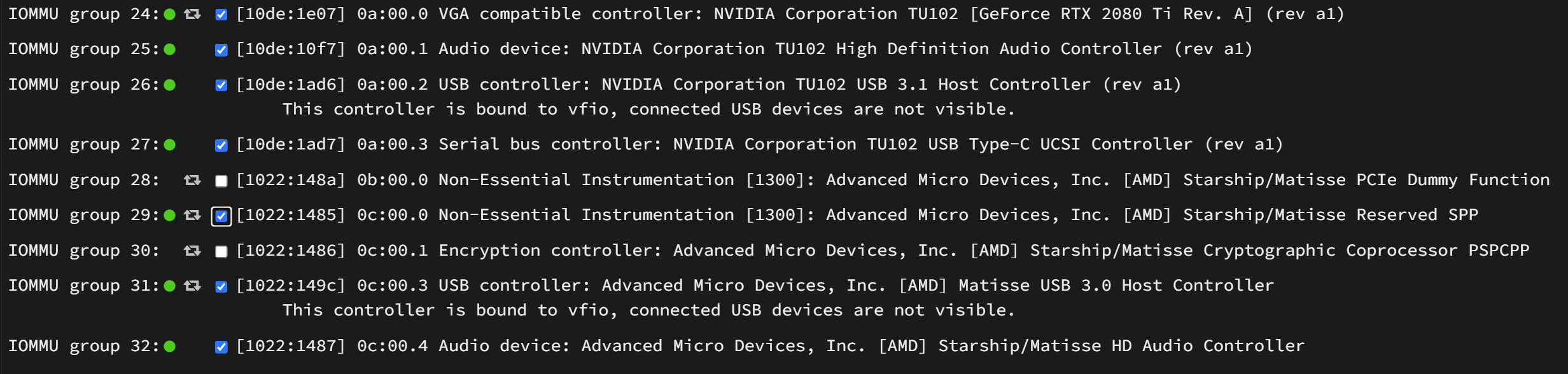

September 17, 20223 yr No hope with x470 gaming 5 motherboard problem exists forever no flr support with latest f63c bios and 6.10.3 unraid system The temporary solution for me is to do pcie_no_flr=1022:148a,1022:1485,1022:1486,1022:149c,1022:1487 http://patchwork.ozlabs.org/project/linux-pci/patch/[email protected]/#2758883 <--reason why im doing this and do vfio bind as shown in the pic in this case, it stop crashing when the vm starts and did actually go into the windows logon menu. However! it still crashes when im logging in. I disable the windows startup sound, and I got no problems anymore.(weird, but I guess it might be some driver issues?) I stop configuring anything by then. I have spent too much time troubleshooting, I am losing interest messing up vm stuffs.
