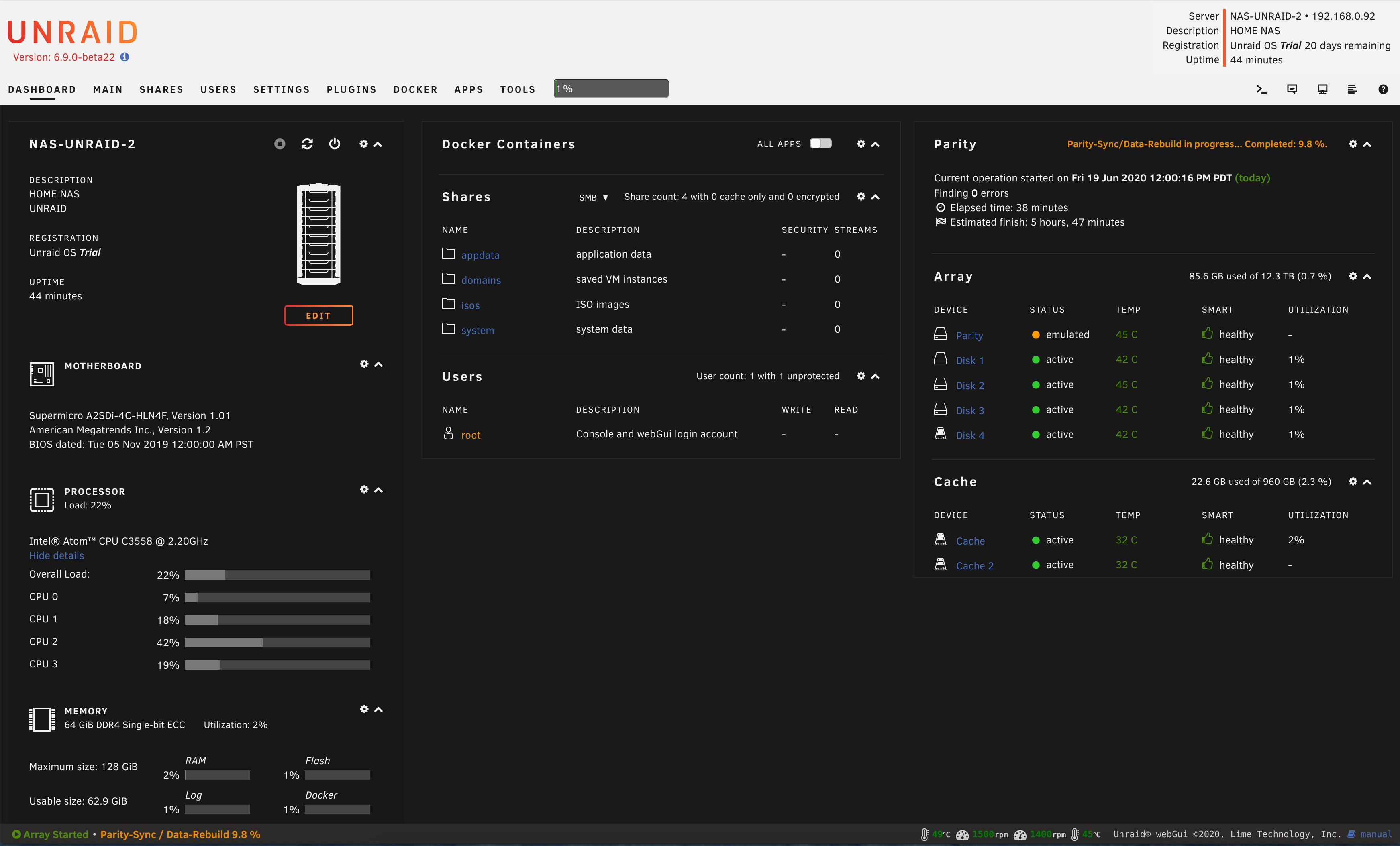

I hear you brother.  But something interesting.  Just installed the BETA Version: 6.9.0-beta22 just for the hell of it since I have a second Unraid to play around and it has been SOLID?  Same hardware.  Something changed in this beta to give me different results.  Is doing a parity re-build now and is solid, no errors, nothing.
I did order an LSI 2008 just like my other Unraid but meanwhile I am playing with this :)
519958506_ScreenShot2020-06-19at2_38_37PM.thumb.png.6520d40728b2160c177d7471655dd6b2.png
