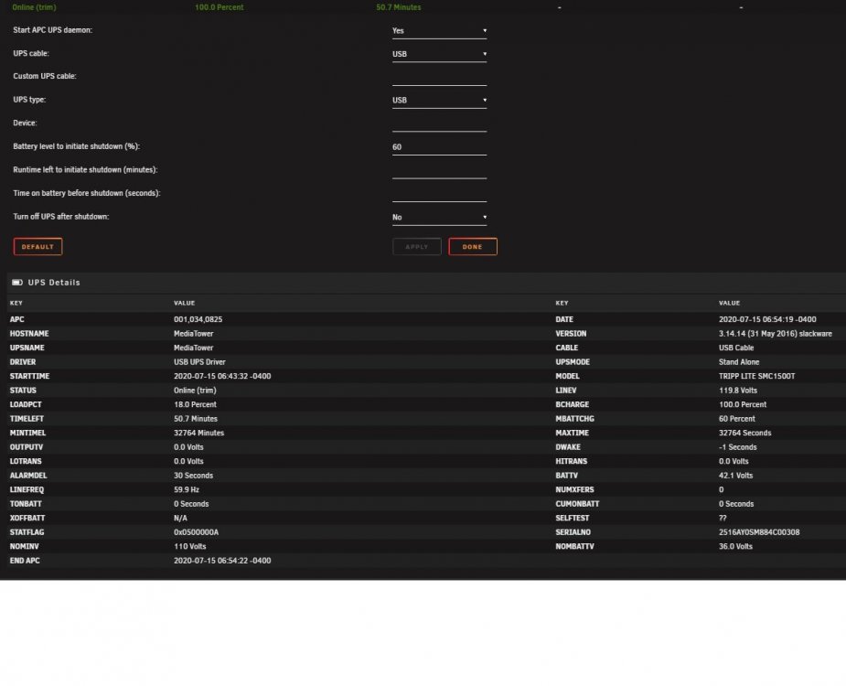

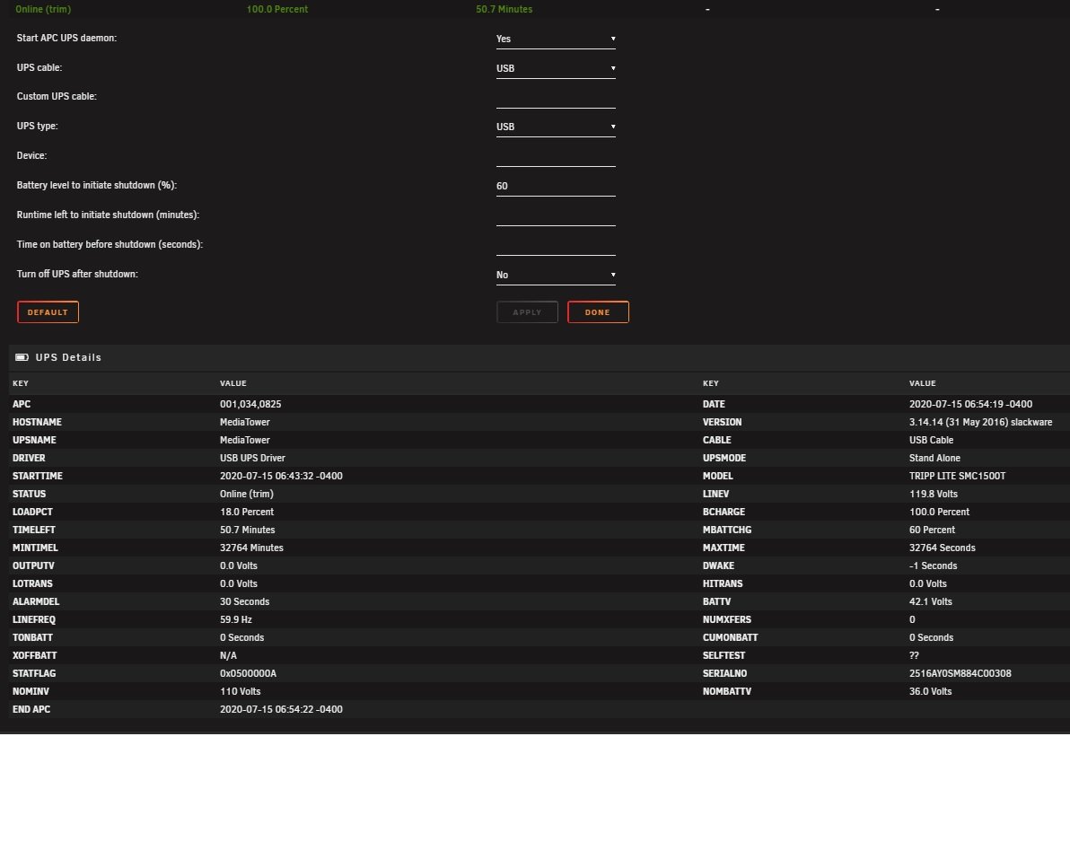

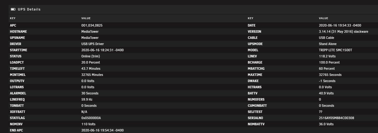

I had a power failure today but my syslogs show a battery minimum was hit almost immediately. Then it says the power came back on. Here is an excerpt from today(june 16). The only parameter I have in UPS Settings is Battery % to Initiate Shutdown = 60%.  Why is this happening?  I am not convinced there was a power outage today my stove and microwave clocks still show the time.  UPS reports 100% charge wih ~ 43 Minutes of run time.  I manually powered the server back up ~ 6:30pm and everything seems fine so far.

I powered down the server and installed 3 new 12.7ah batteries into the UPS.
Powered up the UPS and ran a self-test/diagnostic.  Powered my server back up.
Brought the server back to normal load with dockers/VM's running.
Shut off the breaker to the UPS. Again same issue - Server powers down within a minute of turning off the breaker.
If I understand the config it should keep running on batteries until it drops to 60%.
What is the issue?
Entered legit values for Runtime Left and Time On Battery.  Cut the power at the breaker, this time no immediate shutdown.
I let the server run for 10 minutes on battery power then flipped the breaker back on.
I now have a new set of batteries which I probably needed anyways so I think we can consider this resolved.
