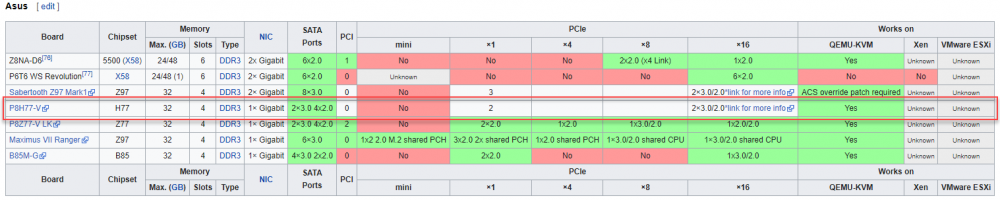

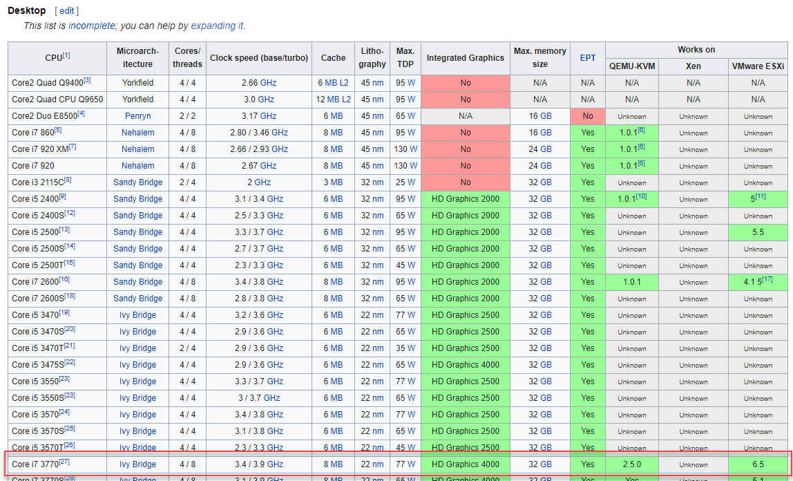

Okey so I found this Wikipedia list https://en.wikipedia.org/wiki/List_of_IOMMU-supporting_hardware
And this is my current hardware
CPU: i7 3770
Motherboard: ASUS P8H77-V LE
GPU: MSI GeForce GTX 970
I paste the two screenshots below, can you help me translate the tables? does it support IOMMU?
It looks like it, I guess?
Motherboard
CPU

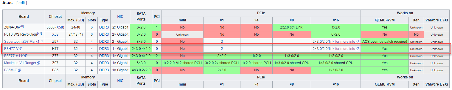

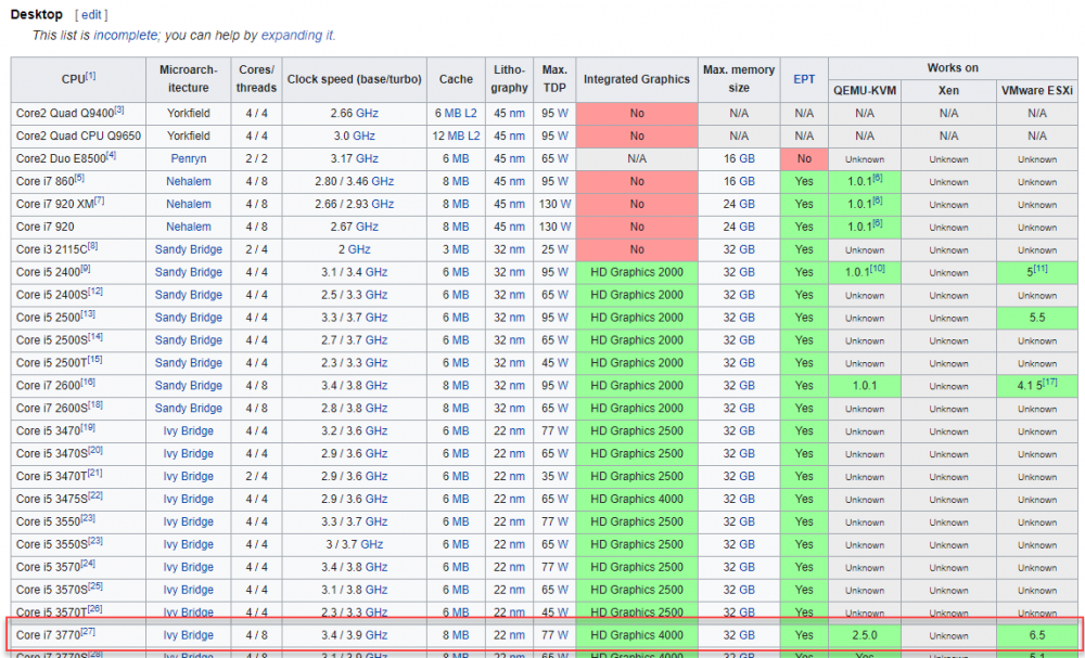

20 hours ago, Pyrre said:
Thank you so much for the answer, exactly what I was looking for :)
CPU: i7 3770
Motherboard
CPU
Unraid uses KVM QEMU so you're good to go.
On the Intel side IOMMU is found in BIOS as VT-d. So you need to have this enabled.
Also you need enabled Virtualization Technology probably found as VT-x in BIOS.
