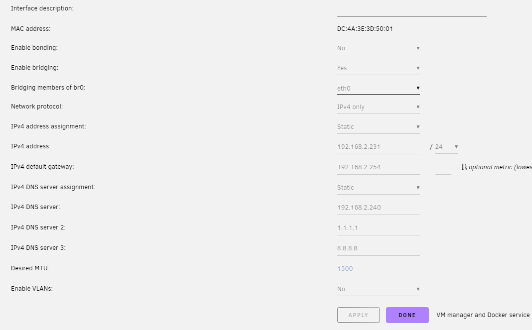

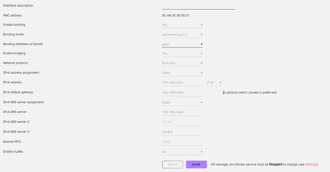

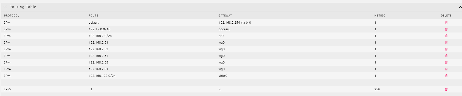

Okay, i've got the issue tracked down:
When my VM is using network bridge Br0 my unifi access points go unresponsive. When i use the only other one avaible: Virbr0 my access points will stay responsive, yet i have no internet on my VM. My network settings:
image.thumb.png.46883920eea1048831fc8dbd389186aa.pngimage.thumb.png.138d557f30048607913cfefb90de4b0f.png
Anyone know what setting is wrong?
My question is, how can i get Br0 to work that i can get a ip range in the 2.0/24 instead of virbr0 which sets me in 122.0/24 range.
I don't know if it is relevant but why do you have bonding enabled if their is only one NIC defined?
Should i set "Enable Bonding" to no?
Are the wg0 interfaces wireguard interfaces? I think some other people on the forums have had issues with wireguard and bonded nics but obviously I dont know if that is your issue, just mentioning this in case.

So i've tested by disabling bonding:
But no success, devices still go on adopting on the wifi portal and my pi-hole stops answering do DNS requests. i've included the new diag
