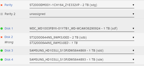

The new array disk shows as present, the ID is correct but Unraid has marked it as wrong and the capacity is showing as 1TB rather than 2TB.  Also, my parity disk which was showing errors on the rsync has now been marked as failed too, so I can't start the array at all any more now.
If I could just get the capacity issue resolved and get unraid to recognise that disk 2 is the correct disk, I can start the array and replace the parity disk again with another spare 2TB I have by the side of me, but with both parity failed and disk 2 not being recognised correctly, I'm screwed.
I've swapped the connectors around, changed 'sides' on the HBA, even connected the disk to the motherboard SATA connection directly - no change, still being seen as the wrong disk.
Diagnostics and screenclip of the issue attached - anyone got any advice ?

Do a new config, then you can re-sync parity.
Perfect - thank you.  Array now started and parity being re-synced to new drive, all is well with the world once more (kinda).
