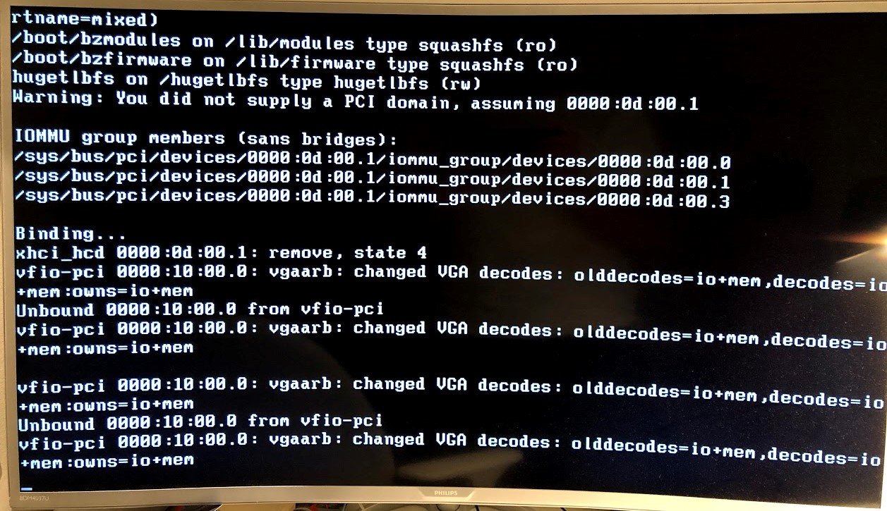

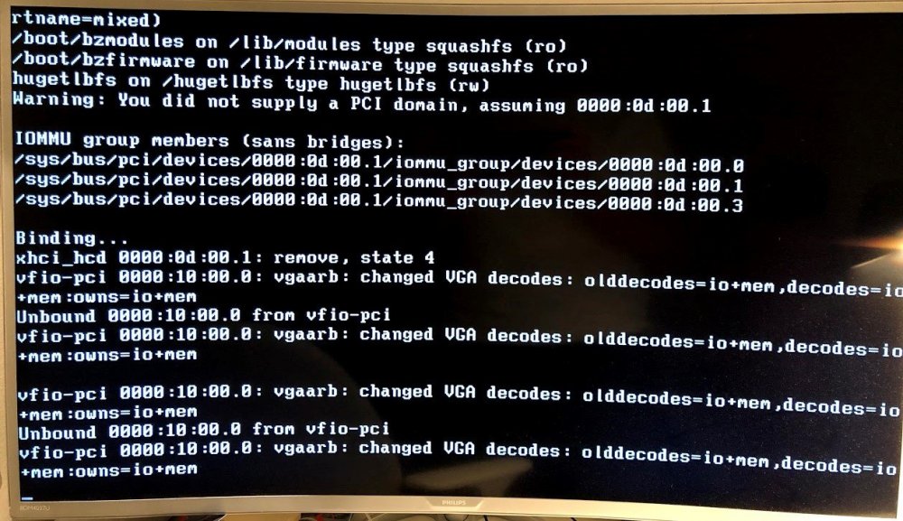

Also during startup, instead of endning with the login command line prompt and the server IP address as usual, I get the following screen:
It never goes further, but the server is eventually reachable over the network as usual anyway.
