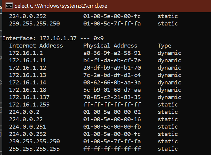

Well, from the networking standing. I'm not traversing any vlans from the unraid to my computer. Everything is on Vlan 1 default. Which, means it's already doing that.
I'm in the same arp table

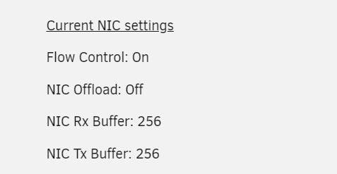

You can try the "Tips and Tweaks" plugin, which allows to make some low level changes for the ethernet interface, nothing guaranteed though!
Do you know if this problem could be caused by a plugin?  I mean my server is always running pretty idle.
Omg!
thanks!!! Tips and tweaks solved the problem. I disabled the Nic Offloading, looks like it was the culprit
