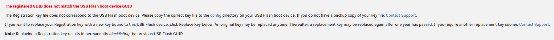

So, today I set up the second microserver and installed the UnRaid OS onto a USB drive... I have booted it and tried to set it up from memory, last time I had more help from the friend mentioned above.  The first thing that I did was to enter my UnRaid Server OS Plus Key..... however.... that did not go well.
In essence I got this message:
"The registered GUID does not match the USB Flash boot device GUID
The Registration key file does not correspond to the USB Flash boot device. Please copy the correct key file to the config directory on your USB Flash boot device. If you do not have a backup copy of your key file, Contact Support.
If you want to replace your Registration key with a new key bound to this USB Flash device, click Replace Key below. An original key may be replaced anytime. Thereafter, a replacement key may be replaced again after one year has passed. If you require another replacement key sooner, Contact Support.
Note: Replacing a Registration key results in permanently blacklisting the previous USB Flash GUID."
So, my question is.... have I effed up?  And is there a simple guide on how to fix this, without blacklisting anything?

18 minutes ago, Loosetooth said:
I went ahead and purchased an UnRaid Plus license key to allow me to have 12 drives attached - I actually thought that that would allow me 3 microservers, but I forgot to count the SSD I installed as a device, doh.
Licenses don't apply across multiple machines, one license per machine, drive limit on that specific box.
Each USB Unraid stick must have a unique license.
What he said.
If you use that original flash on the first server, then it will be fine and won't get blacklisted. In fact, as long as you use that original flash with its registered key on any server it won't get blacklisted. But to have 2 servers running at the same time you have to have 2 licensed flash drives, one for each.
You will have to get another license for the flash drive on the second server.
