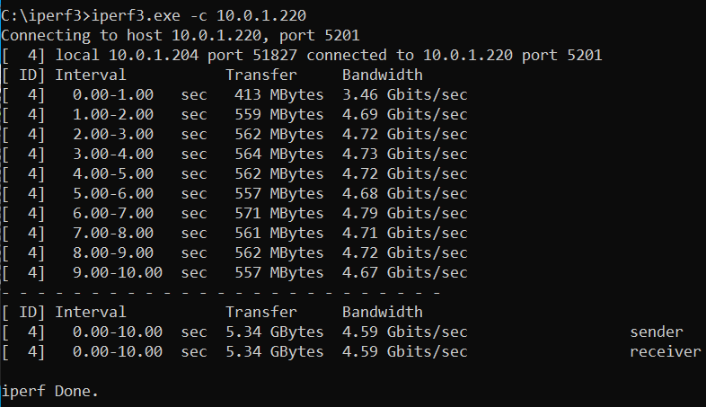

Start by running a single stream iperf test to check if the LAN is performing as expected.
Sure, here is what I got:
That suggest a problem with the LAN itself, you should get close to line speed with iperf when all is working as it should be.
