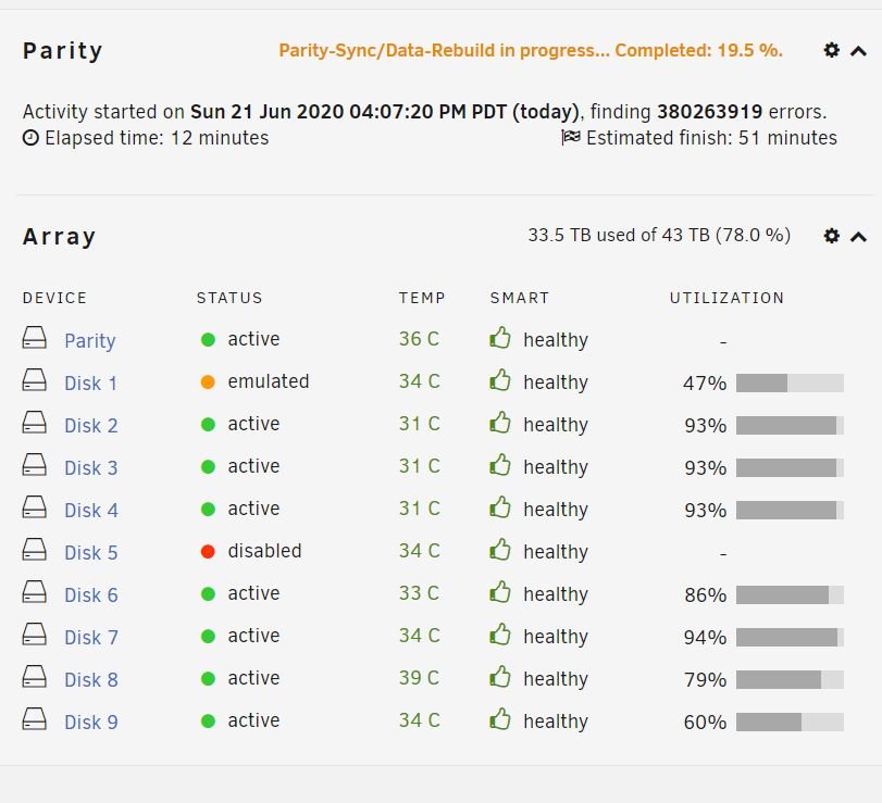

Now my Disk1 is listed as "emulated" and data re-build is running.. however another fully working disk I have in the array (Disk5) is now marked as "disabled" with a message saying "unmountable file system" (See the attached picture of my array status)
What has gone wrong here? Did I lose data? What to do from here? My Disk5 has xfs file system and it still shows as xfs in the main page but with the above message..

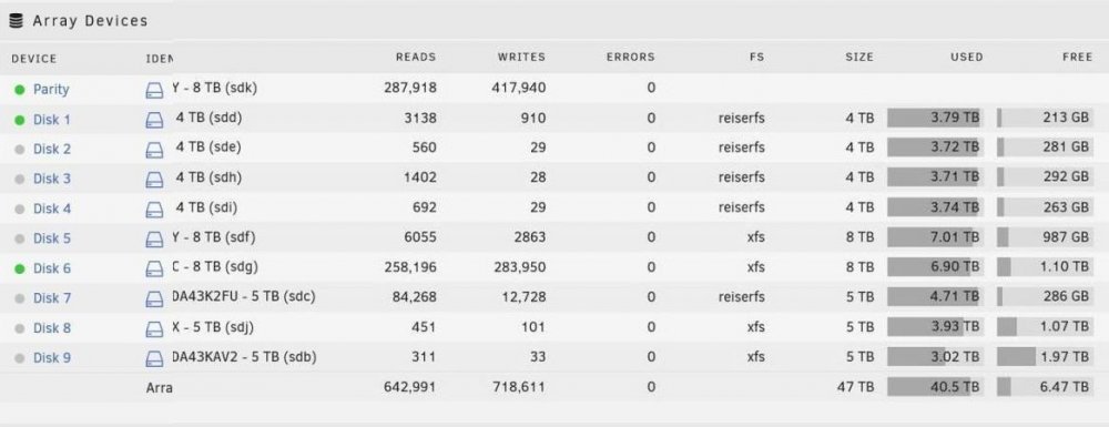

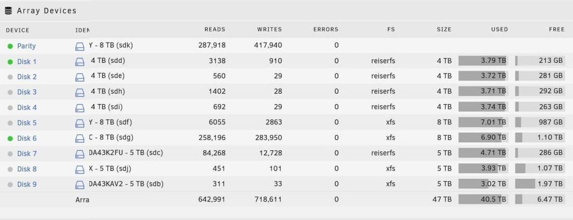

OK data-rebuild is complete now.. and here are the main page summaries "before" and "after" my disk upgrade attempt for Disk1.
The "Used" column of 2 pictures seems to show the replaced drive may have correctly re-build what was on Disk1 removed drive. (All sizes seem to match)

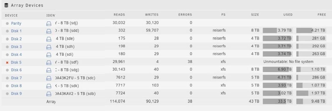

Only Disk5 is now marked "unmountable: No File System". Does this mean Disk5 is the only one I need to worry about now?

Single parity can't emulated 2 disks, disk5 dropped offline so there's no SMART, check connections and post new diags.

Disk wasn't offline during the boot, it dropped offline during the rebuild, and again, since single parity can't emulate 2 disks both disks currently have invalid data, now either disk5 died making recovery more difficult, or more likely it's just a connection problem, but we need the SMART to have a better idea, nothing you can do before rebooting/power cycling to see what's what.

Thanks! I did exactly as you suggested... shutdown, unplug and plug back in the cables for Disk5, power back on. Disk5 still shows as "Unmountable: No File System". Glance at syslog seems to indicate a corruption??
