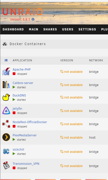

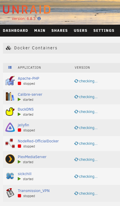

I am getting this error whenever I check for docker updates:
Jun 22 20:52:37 Tower nginx: 2020/06/22 20:52:37 [error] 8724#8724: *3066436 upstream timed out (110: Connection timed out)
while reading response header from upstream, client: 10.10.0.12, server: , request: "POST
/plugins/dynamix.docker.manager/include/DockerUpdate.php HTTP/1.1", upstream:
"fastcgi://unix:/var/run/php5-fpm.sock", host: "10.10.0.3", referrer: "http://10.10.0.3/Docker"
It stays in "checking" for ages, then reverts to orange text "not available"
image.png.2d5a55c9758e15f2d4e7bea7cd5b73ef.png image.png.d9333ee84b82abbe5853473c12e8b82d.png

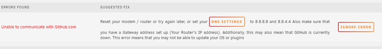

So it get's even weirder - I checked Settings --> Fix Common Problems and got this:
Maybe I just need to reset my router. Maybe back to factory condition and set it up again. Sigh.
(Note that I am not seeing any symptoms of misbehaving router on 30+ other devices on the network)
