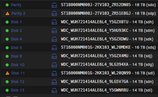

I had a couple of disk failures that resulted in a dual Parity swap procedure - Successfull
I then recieved some newer replacement HDD that necessitated another dual parity swap procedure. Parity copy went smoothly, prior to the disk rebuild, I accidentally clicked a drop down on the main page. This meant that I would have to redo the parity copy (16-->18TB). I then did a search, and came across this thread (which should be linked from ther Parity Swap procedure page!)
Everything would have went well, had I not missed the bit about dual parity and not using the "29" at the end of the cmds...
so I now have this:
and this
Disks 5 and 11 were the locations of the original missing/failed disks, that should have been rebuilt on the two old p[arity disks that you can see occupying thier slots (MDKE anbd QN99)
However as I incorrectly entered 29... I am guessing that:
Parity 1 Valid
Parity 2 Invalid (being rebuilt across disk set as you confirmed above)
Disk 5 (original Parity 1) - should be getting overwritten with original emulated Disk 5 data?
Disk 11 (original Parity 2) - should be getting overwritten with origianl emulated Disk 11 data?
So I suppose the real question is, what will the outcome of this be?
Since there were two invalid disks with single parity both rebuilt disks will be corrupt, you can format them and restore the data from the old disks, assuming they are still available.

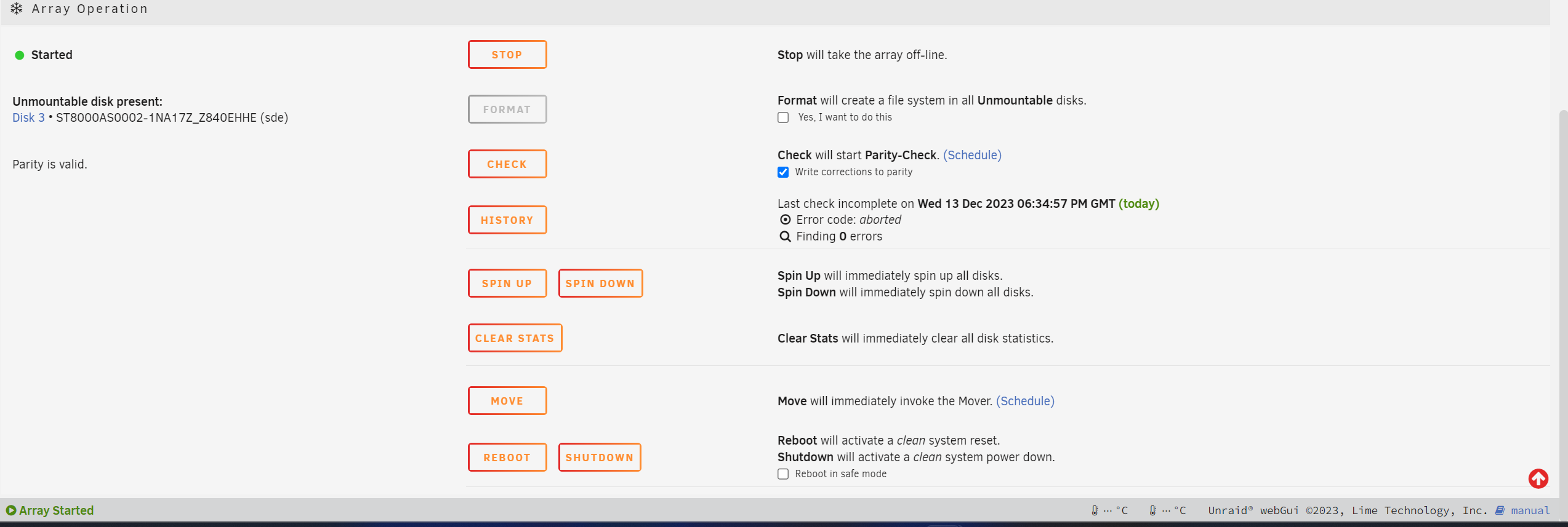

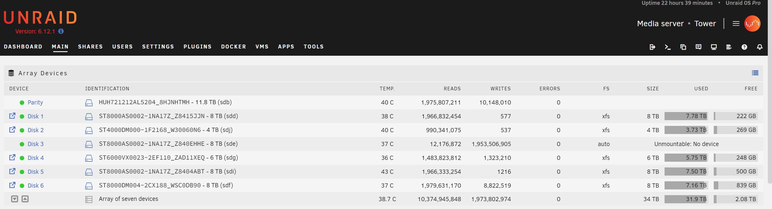

Found this after i did a parity swap and then accidently reloaded the page after the parity was copied over to the new drive. rather than start over again ive found this. the rebuild is completed but the drive is still showing as unformatted and not sure where to go from here.
Please post the diagnostics.
Why was a new config done? It's not a part of the parity swap procedure, post the output of:
fdisk -l /dev/sde
in this it says to 'Tools -> New Config -> Retain current configuration: All -> Apply@

and all i got was
fdisk: invalid option -- '1'
Try 'fdisk --help' for more information.
sorry typed it in wrong the first time. output is:
Disk /dev/sde: 7.28 TiB, 8001563222016 bytes, 15628053168 sectors
Disk model: ST8000AS0002-1NA
Units: sectors of 1 * 512 = 512 bytes
Sector size (logical/physical): 512 bytes / 4096 bytes
I/O size (minimum/optimal): 4096 bytes / 4096 bytes
Disklabel type: gpt
Disk identifier: 60B4E146-6936-4937-A7B8-9E4C99C352C9
Device     Start         End     Sectors  Size Type
/dev/sde1     64 15628053134 15628053071  7.3T Linux filesystem
Reboot and post new diags after array start.

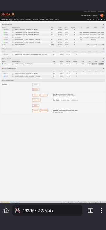

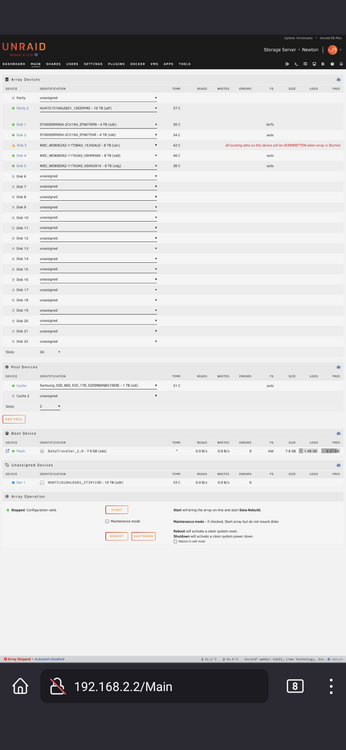

I also had the unfortunate scenario occur to me. I followed the steps described to force the system in the desired state. But my array won't start and seems to be stuck. I know that the mdcmd command came with a remark that it should be used with 29 at the end if the array contains one parity drive. My array meets these criteria, but my only parity disk is assigned as parity 2, which I now found out is disk 29. So I assume this disk being marked as invalid through the command is preventing my array from starting. So I wonder is there any command available that would mark 29 as a valid? e.g "mdcmd set validdisk 29"
Any help would be appreciated!
newton-diagnostics-20240513-1031.zip
Unraid driver crashed, you will need to reboot, having just pariry2 should not be a problem.
A that is good news!
I tried rebooting, but it is unresponsive through the GUI and CLI. So I will physically reboot by holding the power button. And that would be it?
Edited by saltz
quote
1 hour ago, saltz said:
mdcmd command
We're you following the current documentation for parity Swap?
There is no reason to enter mdcmd.
