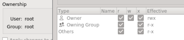

I've had this working for a week or so while I messed with it and imported a bunch of data. That has all worked.
Today I created a new world to actually start bringing in data for one of my current games. I can't import anything and it looks like permissions are wrong. The testing folder is the one I created after install. The other two world folders (and all subfolders) have incorrect permissions.
Any ideas how to fix it?

I copied the folder with Krusader which set the files to nobody instead of root. Now it works.
It looks like it's running as foundry/users but creating folders as root/root?
Edited by quietas
restarting the docker should fix permission problems i have not been able to get specific user creation working in a docker image yet so i added a workaround for now that just needs you to restart the docker.
Good to know. I did that and it works just as you said. I just created a couple and I see that it fixes the permissions.
