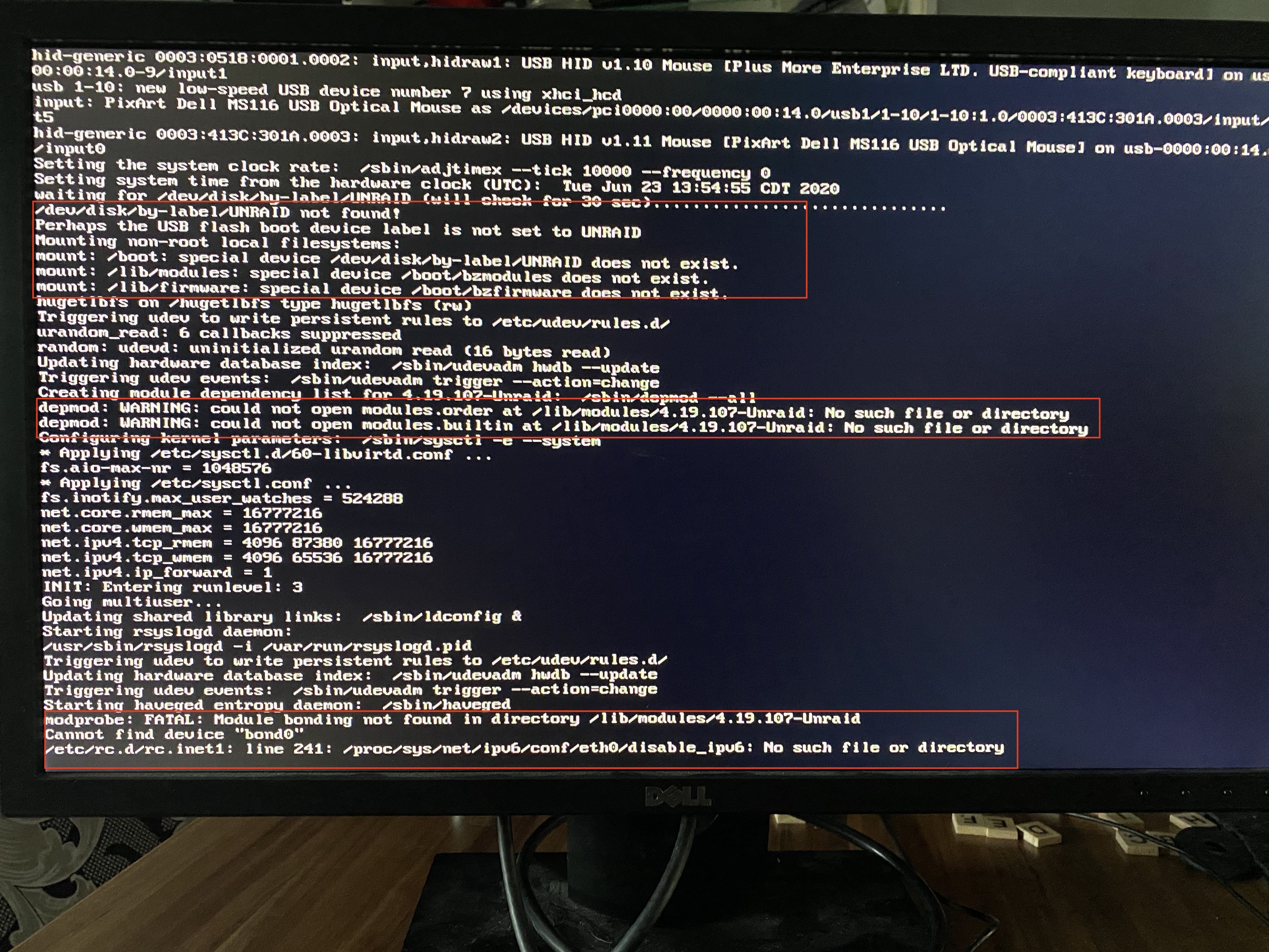

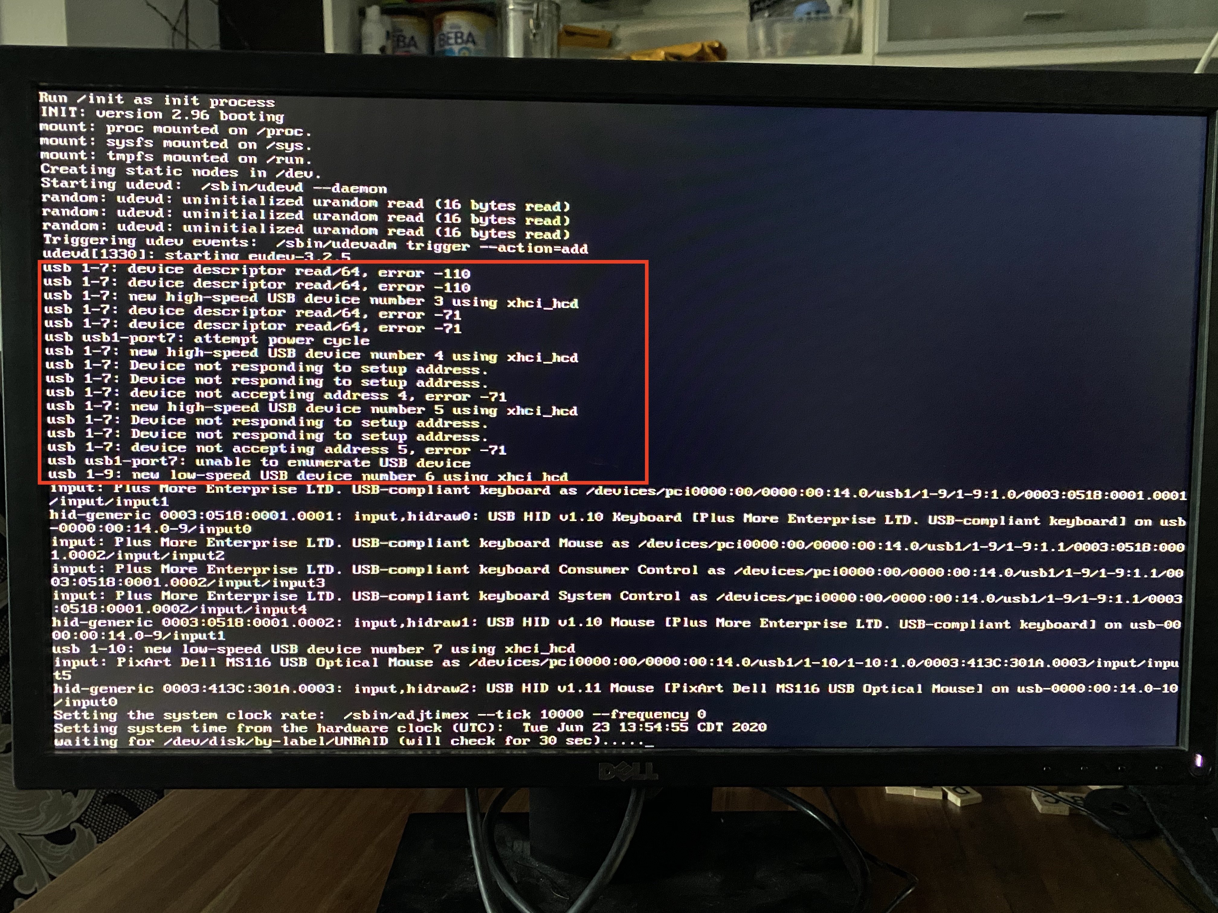

First errors - all in a USB contex
Bunch of errors (FYI - the usb drive definitely named "UNRAID")bunch_of_errors.jpg

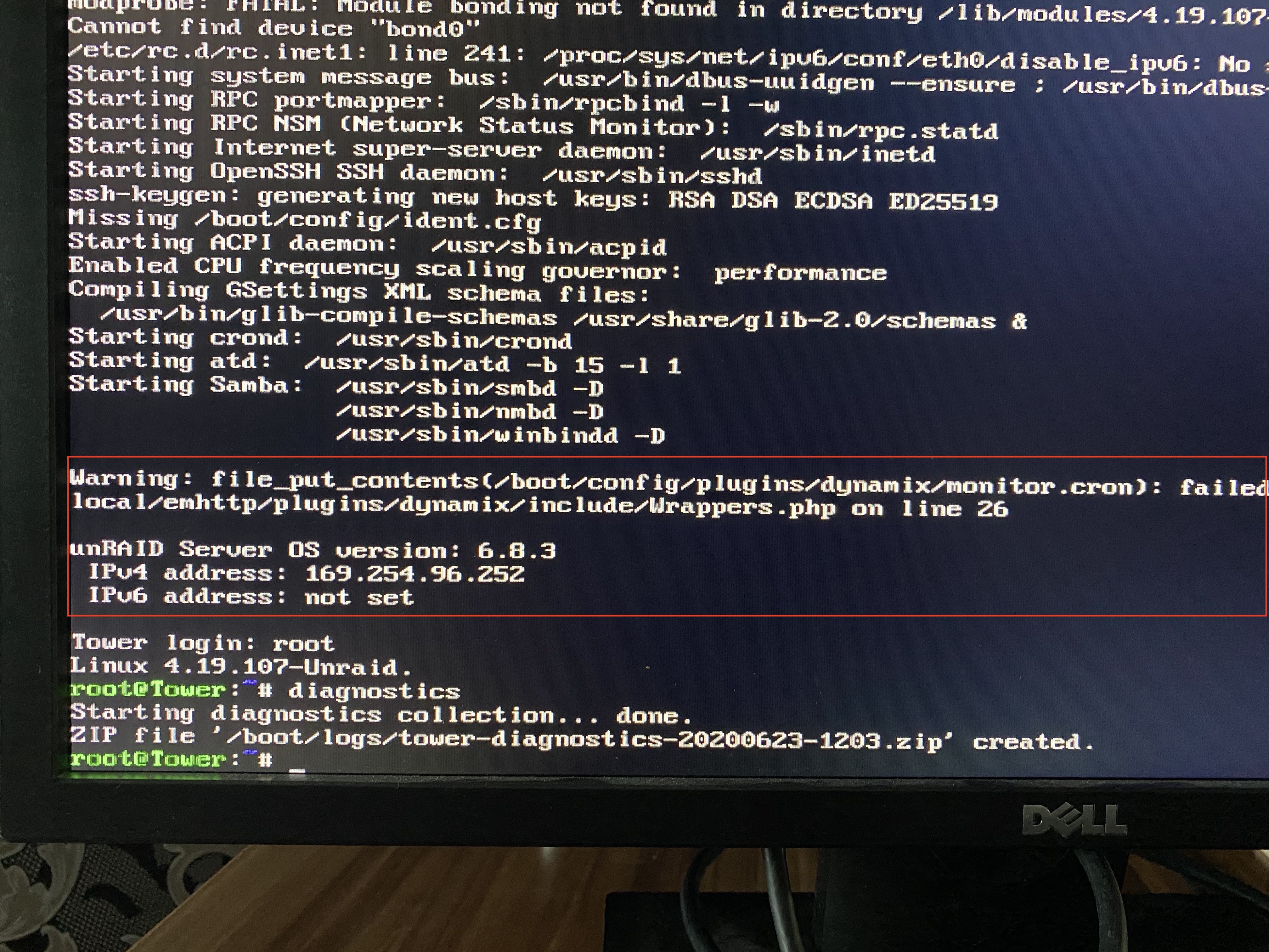

Last errors and wrong IP:

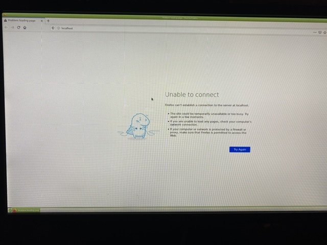

update3: starting unRAID with GUI doesn’t seems to be good either 😪
This suggests a flash drive problem, try re-doing it or using a different one.

FYI - The reason deleting the network config files from the flash drive was not resulting in new ones being created is that unRAID never got to the point of booting.  The flash drive was not found and the bz* files needed to boot unRAID never ran as noted in the errors on the screen.
You definitely had major flash drive problems and I am glad to see that simply using a different flash drive solved the problem.
