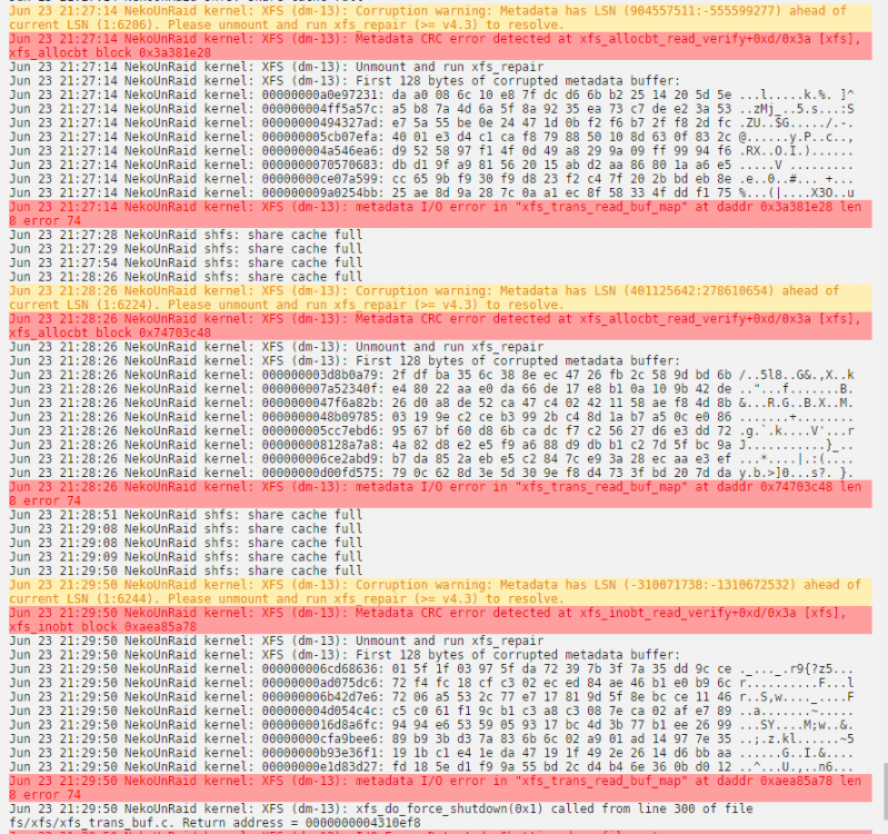

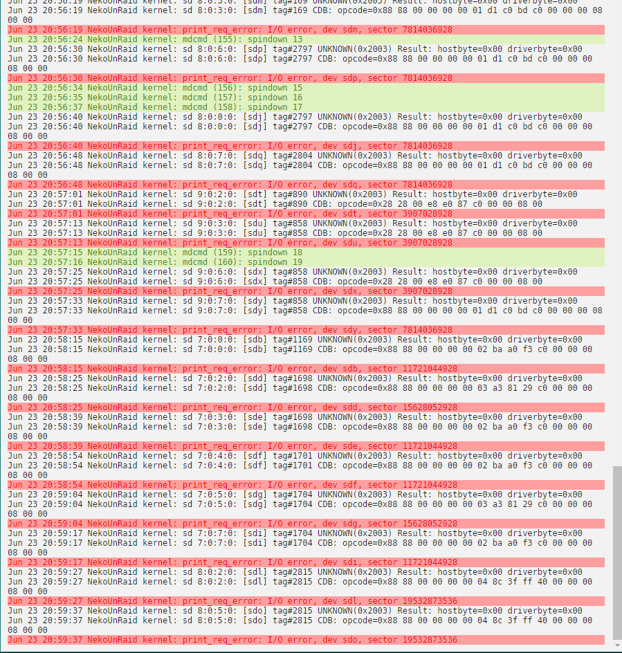

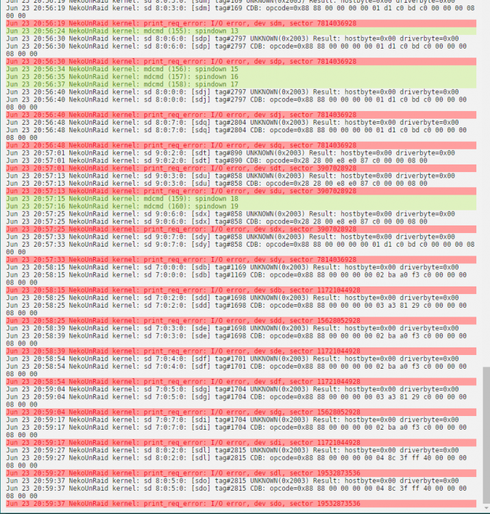

So had some heat issues today, some disks hit 60c before I realised.

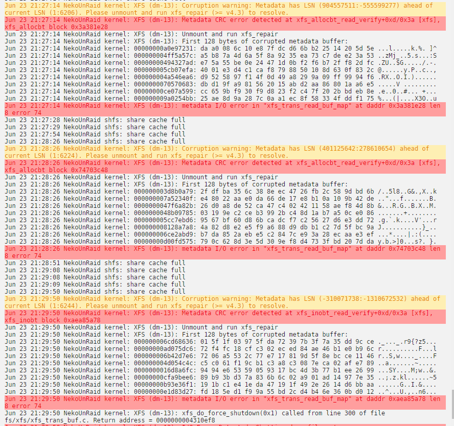

Anyway, I sorted but found some strange behaviour, but primary io write errors from smb, so loaded up logs and found a lot of issues. took array down and up again, no go. rebooted in maintainence and found disk14 reported xfs_check issues, but then after leaving it for a while and checking logs it's filled with below.

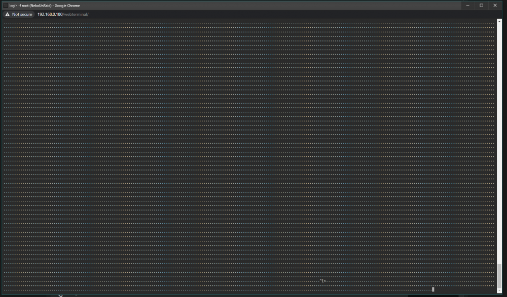

But that's been running for past 15mins trying to find 2ndary superblocks in filesystem

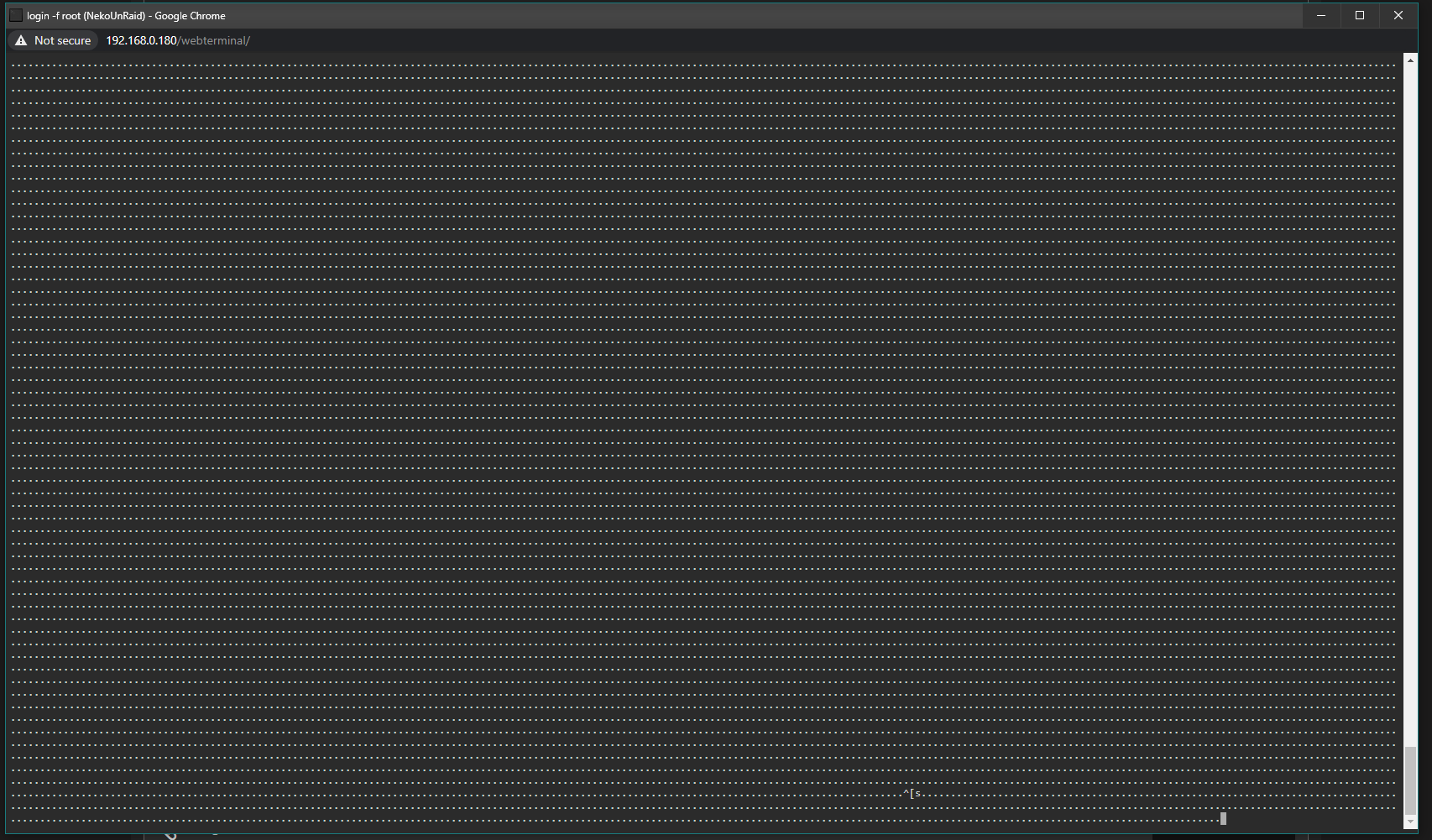

trying to run from webui now only displays this;
not allowing any actions
using md# also returns device is busy

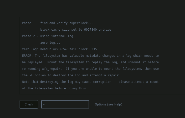

running webgui with a -v flag gives this output;
Phase 1 - find and verify superblock...
        - block cache size set to 6097840 entries
Phase 2 - using internal log
        - zero log...
zero_log: head block 6247 tail block 6235
ERROR: The filesystem has valuable metadata changes in a log which needs to
be replayed.  Mount the filesystem to replay the log, and unmount it before
re-running xfs_repair.  If you are unable to mount the filesystem, then use
the -L option to destroy the log and attempt a repair.
Note that destroying the log may cause corruption -- please attempt a mount
of the filesystem before doing this.
47 minutes ago, trurl said:
What did it actually say?
The -n (nomodify) flag means check but don't repair anything.
After looking around forums a bit more came across similar post,
mod advised to run against /dev/mapper/md# if drives are encrypted (all of mine are btw), then to -L it.
which spits out this output, same as webui
Clearly it wants me to run with -L but that sounds destructive? It's a 12tb mostly filled, I'd really hate to lose it, at this point I'd almost be better to remove it and let parity emulate it probably and move data around before reformatting and adding back to array?
Edited by Mizerka
okay, so I think I'm good now, ended up booting back into full array with md14 mounted, moved all data off of it without issues, then went back into maintenance and could now run -v, once complete I've started array again and seems good fine for last 20mins or so, crisis averted for now. if it didn't -v I'd probably -L and just reformat it if it corrupts the filesystem.
