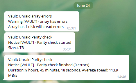

I had some read-errors today and unraid decided to do a parity check.
The triggered parity check told me there was 0 errors in the parity. Which is fine I guess.

I think it is just a conincidence that there was a read error just a few minutes before my scheduled parity check kicked in. Also probably the parity check itself discovered the data read error.
