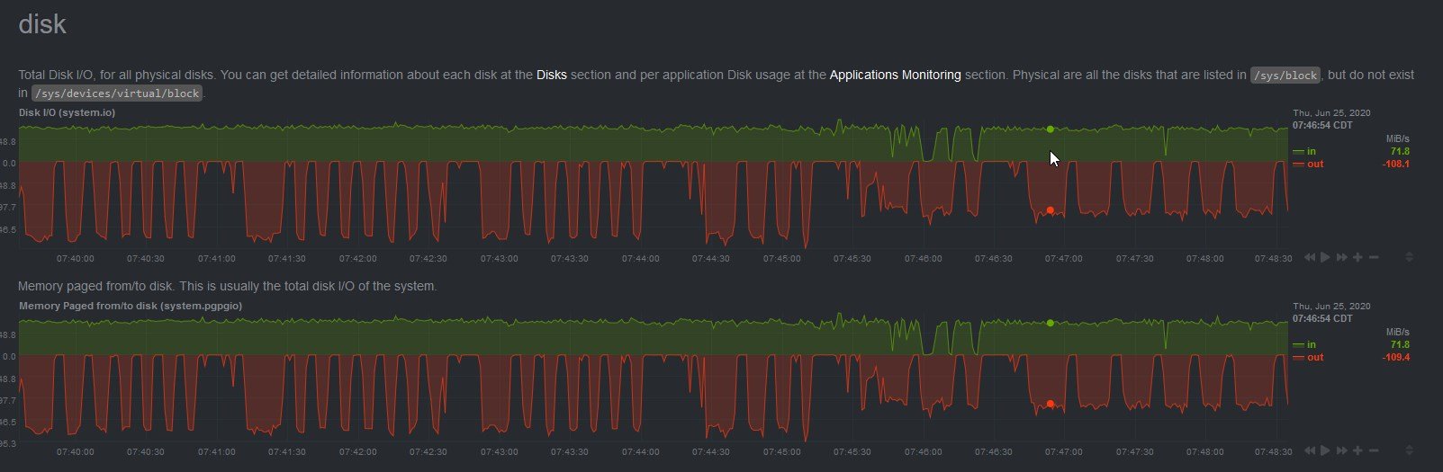

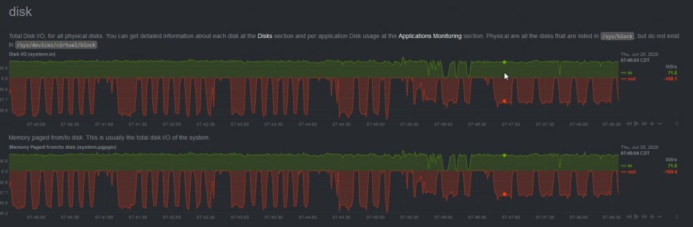

Watching netdata reads seem to be the bottleneck, here is an example from a copy that is happening now:
The reads are using krusader from the cache pool that is capable of over 1GB/s, yet it is almost capped at ~60mb/s which is basically the highest I saw with any of my copies. Meanwhile the writes going in bursts at the expected speed of ~110-120mb/s.

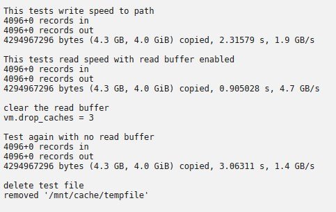

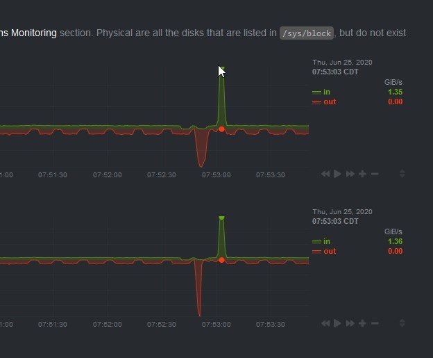

I ran a speed test using dd and the results from cache of as expected even while this copy is happeningfirefox_H8n0AnFj18.jpg.56bca93489148fce7ddab027c9709ec7.jpg
Here is the script I made up to test drive speeds, does anyone know how to run multiple dd commands in parallel? I would like to test all the drives at the same time to see the hardware limits even though I know they are not the issue.
