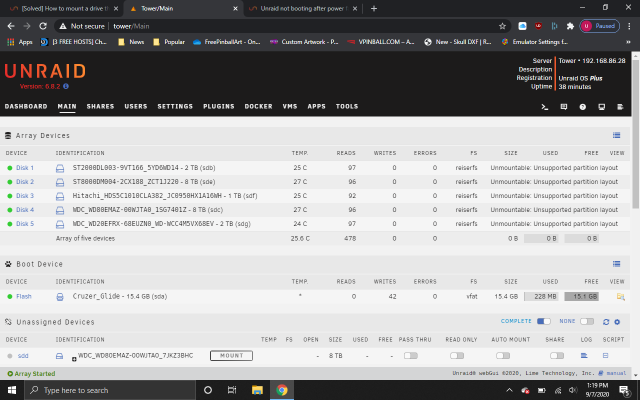

OK so i've attempted the above suggestion finally. Now i've hit a new snag. I left my parity drive unmounted so I didn't erase any of my existing data. When I try to start the array it tells me that all drives are Unmountable: unsupported partition layout. I've added the Unassigned Devices add-on but the only device that I see with more than 1 partition is my Parity drive. Any ideas?
Edited by unstopable1955
Please post current diags: Tools -> Diagnostics
What you say happened doesn't explain the invalid partition errors, did you leave anything out?
Also, do a new config to unassign all disks, to they have the option to mount on UD? Rr do they appear without a partition? Note, if they have the option to mount and you want to do it do it only in read only mode for now.

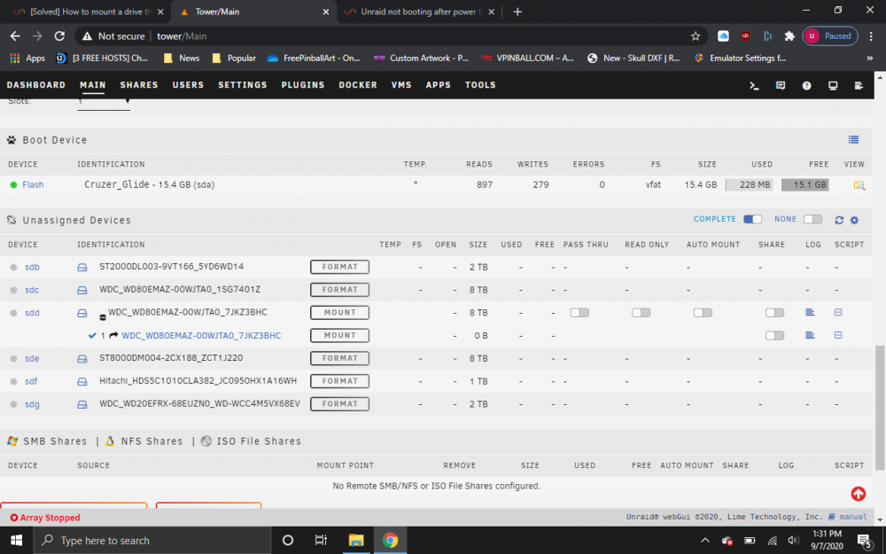

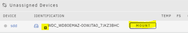

If you do a new config without preserving assignments all disks will be unassigned, they will appear in the UD section, see if they all have an option to mount, i.e. there's still a valid partition (they need to show a plus sign next to them).

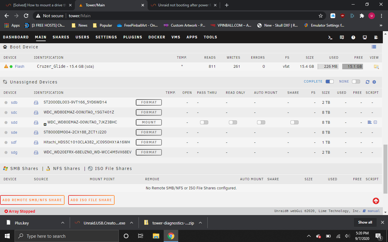

This is how it is if I unassign all drives

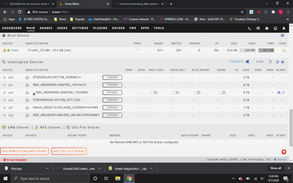

Same thing if I do a new config
Not sure what happened but the partitions are gone, nothing you described explains that, but you're not the first to have something like this happen, though not to all disks as far as I can remember.
You can try testdisk to see if it can find and recover the partition on each disk, if yes try again to mount the disks with UD, If that doesn't work and it's just the partition missing recreating just the partition as it should be might bring the data back, other than that a file recovery utility is probably you best bet, something like UFS explorer.
