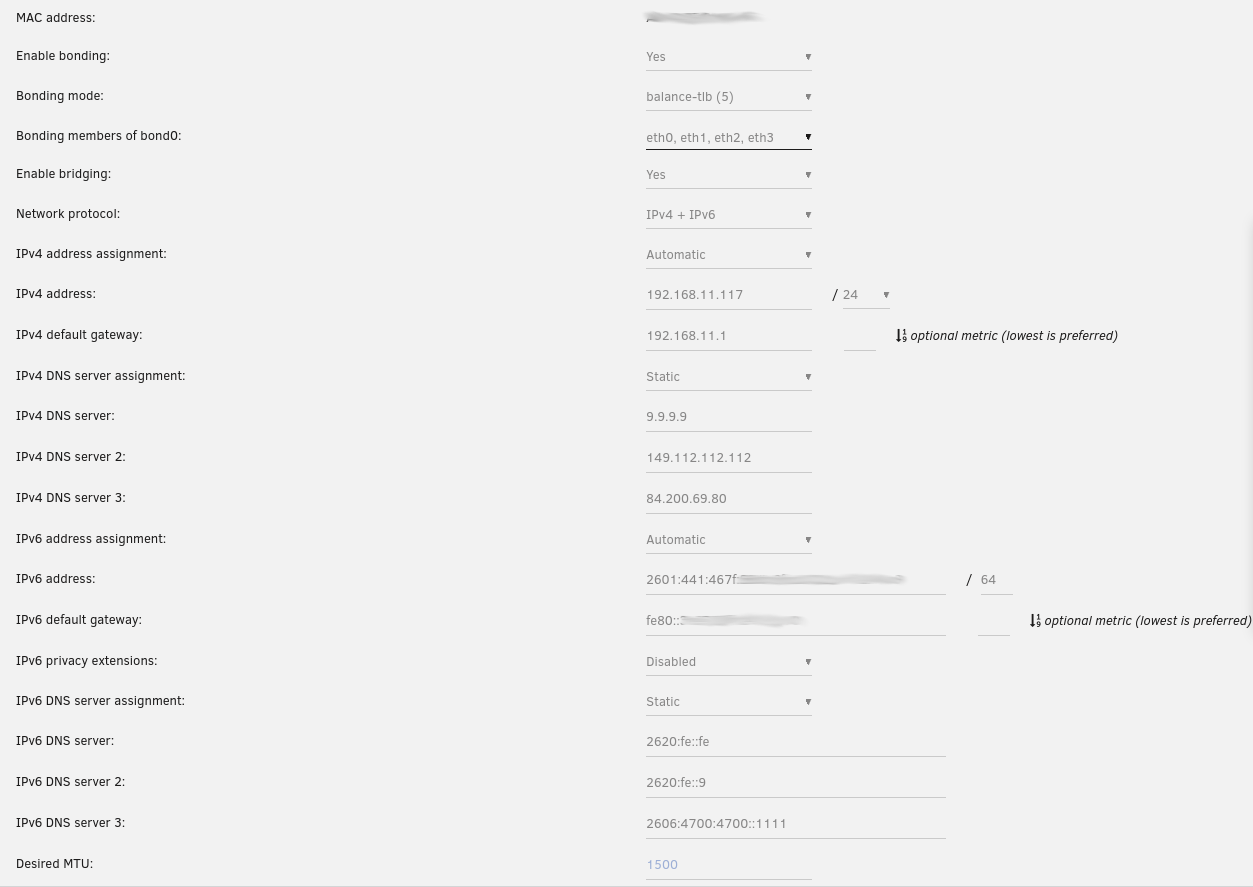

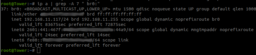

However on the GUI and the command line, the bridge is enabled and has IPv4+IPv6 and the tower itself has an IPv6 address
Any help enabling docker to have IPv6 instead of "EnableIPv6": false will be appreciated

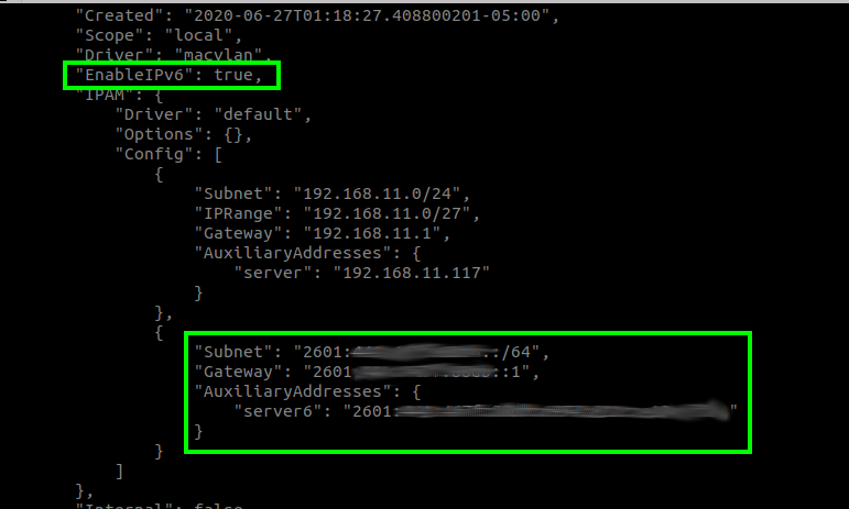

I had some success but ran into a different issue
Could not find a way to create the macvlan in the gui so I ran a slightly different version than the command above which is:
docker network create -d macvlan \
    --ipv6 \
    --subnet=192.168.11.0/24 \
    --subnet=2002:c0a8:0b00::/48 \
    --gateway=192.168.11.1 \
    -o parent=br0 \
    --ip-range 192.168.11.5/27 \
    -o macvlan_mode=bridge macvlan
The reason is my local LAN range is 192.168.11.0/24 and the gateway is 192.168.11.1. Since my DHCP server assigns IPs from 192.168.11.100 to 192.168.11.149 and since I didn't want any IP collisions with the docker network, I went with ip-range 192.168.11.5/27 which has a Start IP of 192.168.11.0 and End IP of 192.168.11.31
When I assign the docker containers that macvlan network, it works and the docker containers surprisingly have perfect IPv4 and IPv6, that also pass the IPv6 test at https://test-ipv6.com/

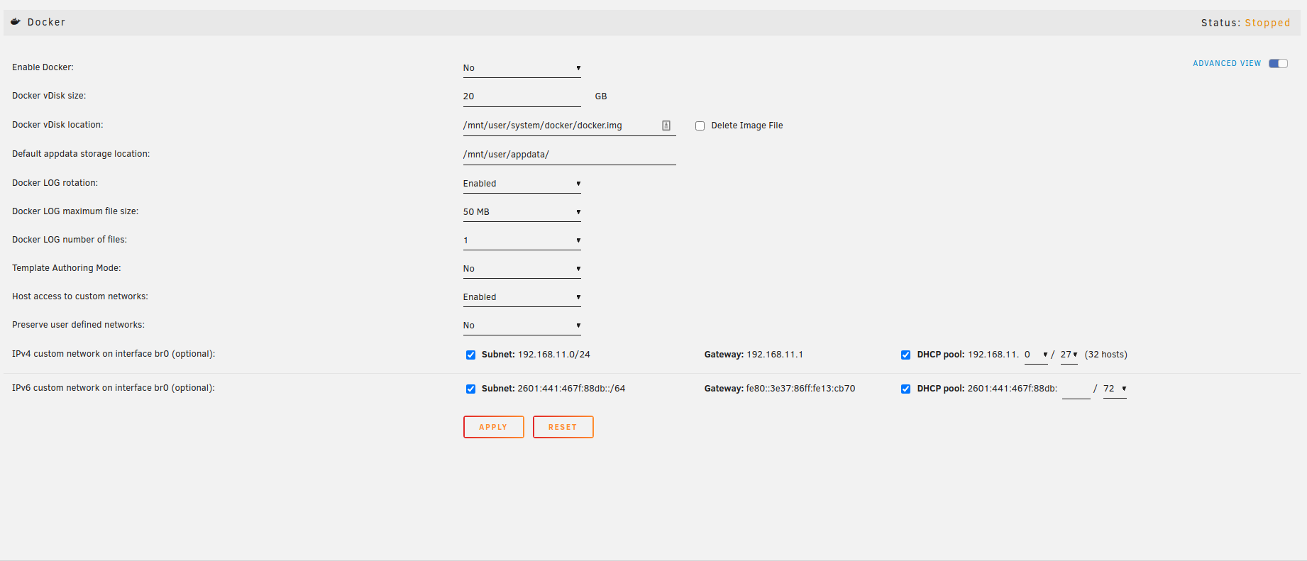

Use the GUI, see Settings --> Docker Settings.
With the Docker service disabled and in advanced view, you can assign the networks.

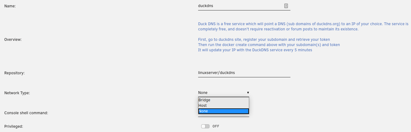

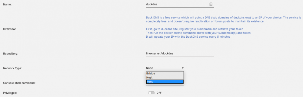

Tried that, all I see is this:
The IPv4 looks fine but no way to bridge that network (macvlan) to IPv6
There is no way to add a network and even with those IPv4 and IPv6 selected, I only have bridge, host, none in my drop down for docker containers as seen below
And per your original reply "Host and Bridge networks use IPv4 only."
There is something missing
5 minutes ago, bonienl said:
Disable the IPv6 DHCP pool.
Wow! I totally did not expect that would work
# docker network ls
NETWORK ID          NAME                DRIVER              SCOPE
6e05b4103d51        br0                 macvlan             local
4619d293ec0b        bridge              bridge              local
bb9929d48bc0        host                host                local
19eea3a1aa0b        none                null                local
THANK YOU!
