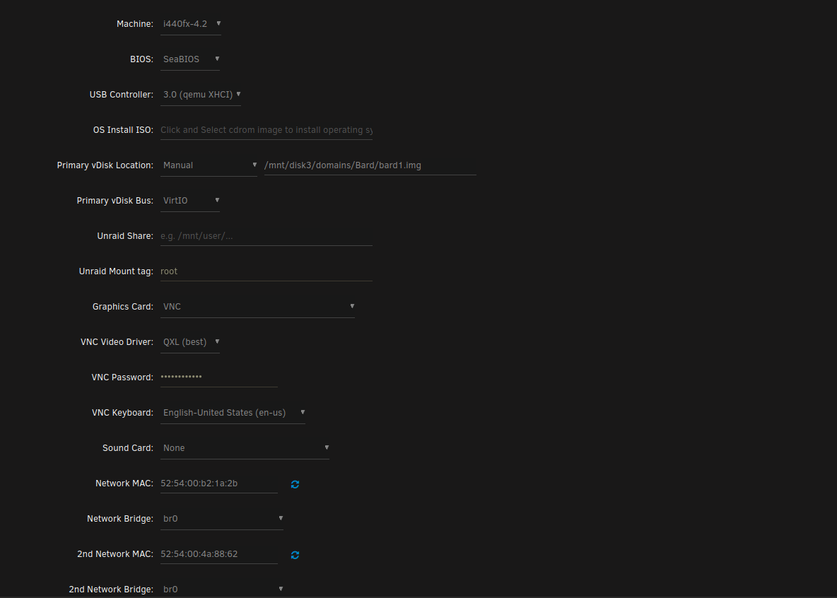

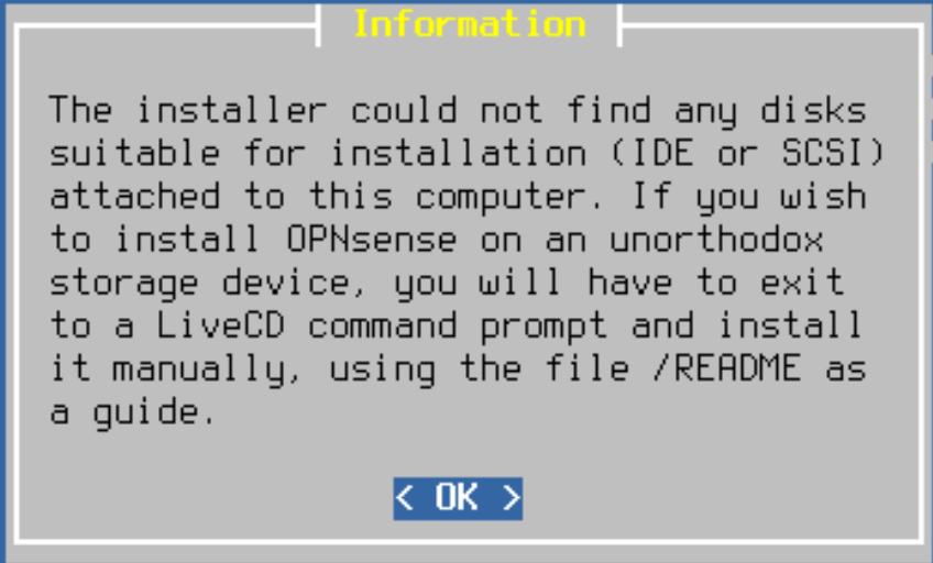

I tried 2 more VM's with different settings:
When creating them I selected emulated CPU mode. Apart from that I tried one 1 VM with Primary vDisk Bus with SATA and one with SCSI. With the first VM I was able to get into the setup menu but when selecting guided install the following message appears "The installer could not find any disks suitable for installation (IDE or SCSI)" That is why I tried the second one with SCSI but then the same message pops up.
xml and screenshot:

<domain type='kvm' id='40'>
  <name>Bard</name>
  <uuid>92346885-a31e-1c8d-3bc9-6a32b0f13e8a</uuid>
  <metadata>
    <vmtemplate xmlns="unraid" name="FreeBSD" icon="freebsd.png" os="freebsd"/>
  </metadata>
  <memory unit='KiB'>3145728</memory>
  <currentMemory unit='KiB'>3145728</currentMemory>
  <vcpu placement='static'>4</vcpu>
  <cputune>
    <vcpupin vcpu='0' cpuset='4'/>
    <vcpupin vcpu='1' cpuset='10'/>
    <vcpupin vcpu='2' cpuset='5'/>
    <vcpupin vcpu='3' cpuset='11'/>
  </cputune>
  <resource>
  </resource>
  <os>
    <type arch='x86_64' machine='pc-i440fx-4.2'>hvm</type>
  </os>
  <features>
    <acpi/>
    <apic/>
  </features>
  <cpu mode='host-passthrough' check='none'>
    <topology sockets='1' cores='2' threads='2'/>
  </cpu>
  <clock offset='utc'>
    <timer name='rtc' tickpolicy='catchup'/>
    <timer name='pit' tickpolicy='delay'/>
  </clock>
  <on_crash>restart</on_crash>
  <devices>
      <driver name='qemu' type='qcow2' cache='writeback'/>
      <source file='/mnt/disk3/domains/Bard/bard1.img' index='1'/>
      <backingStore/>
      <boot order='1'/>
      <alias name='virtio-disk2'/>
    </disk>
    <controller type='pci' index='0' model='pci-root'>
      <alias name='pci.0'/>
    </controller>
      <alias name='ide'/>
    </controller>
      <alias name='virtio-serial0'/>
    </controller>
    <controller type='usb' index='0' model='qemu-xhci' ports='15'>
      <alias name='usb'/>
      <address type='pci' domain='0x0000' bus='0x00' slot='0x07' function='0x0'/>
    </controller>
    <interface type='bridge'>
      <mac address='52:54:00:b2:1a:2b'/>
      <source bridge='br0'/>
      <target dev='vnet2'/>
      <model type='virtio'/>
      <alias name='net0'/>
    </interface>
      <mac address='52:54:00:4a:88:62'/>
      <target dev='vnet3'/>
      <alias name='net1'/>
    </interface>
    <serial type='pty'>
      <source path='/dev/pts/2'/>
        <model name='isa-serial'/>
      </target>
      <alias name='serial0'/>
    </serial>
    <console type='pty' tty='/dev/pts/2'>
    </console>
    <channel type='unix'>
      <source mode='bind' path='/var/lib/libvirt/qemu/channel/target/domain-40-Bard/org.qemu.guest_agent.0'/>
      <target type='virtio' name='org.qemu.guest_agent.0' state='disconnected'/>
      <alias name='channel0'/>
    </channel>
      <alias name='input0'/>
    </input>
    <input type='mouse' bus='ps2'>
      <alias name='input1'/>
    </input>
    <input type='keyboard' bus='ps2'>
      <alias name='input2'/>
    </input>
    <graphics type='vnc' port='5902' autoport='yes' websocket='5702' listen='0.0.0.0' keymap='en-us'>
    </graphics>
    <video>
      <alias name='video0'/>
    </video>
    <memballoon model='virtio'>
      <alias name='balloon0'/>
    </memballoon>
  </devices>
  <seclabel type='dynamic' model='dac' relabel='yes'>
    <label>+0:+100</label>
    <imagelabel>+0:+100</imagelabel>
  </seclabel>
</domain>

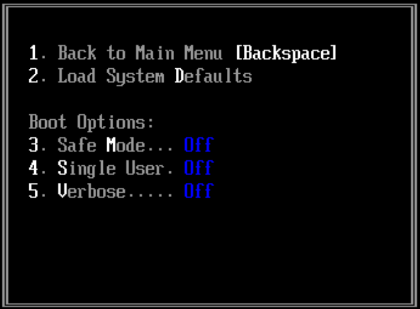

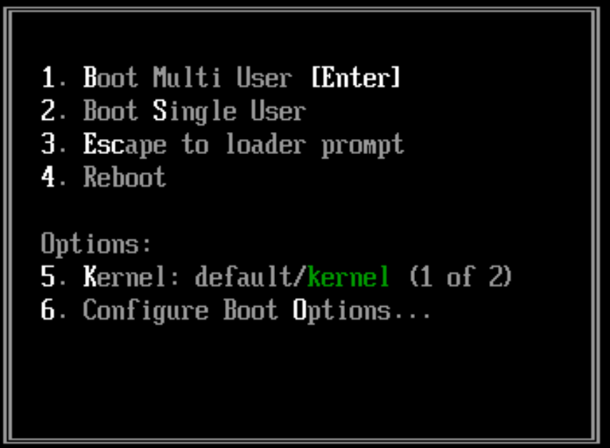

During booting I get the option to go to:
I got the option to change the Kernel to "Kernel.old" but when I select that option during boot I get "Kernel not found". Assuming you meant this in the first place.
My disks are virtio is that what you are using?
I missed that in your previous post sorry about that. I just tried a VM with virtio and the only difference as I can see so far is that in the boot menu I am able to toggle ACPI support on/off
Trying the old kernel still produces "kernel not found". Booting with ACPI off instead of on also does not work.
