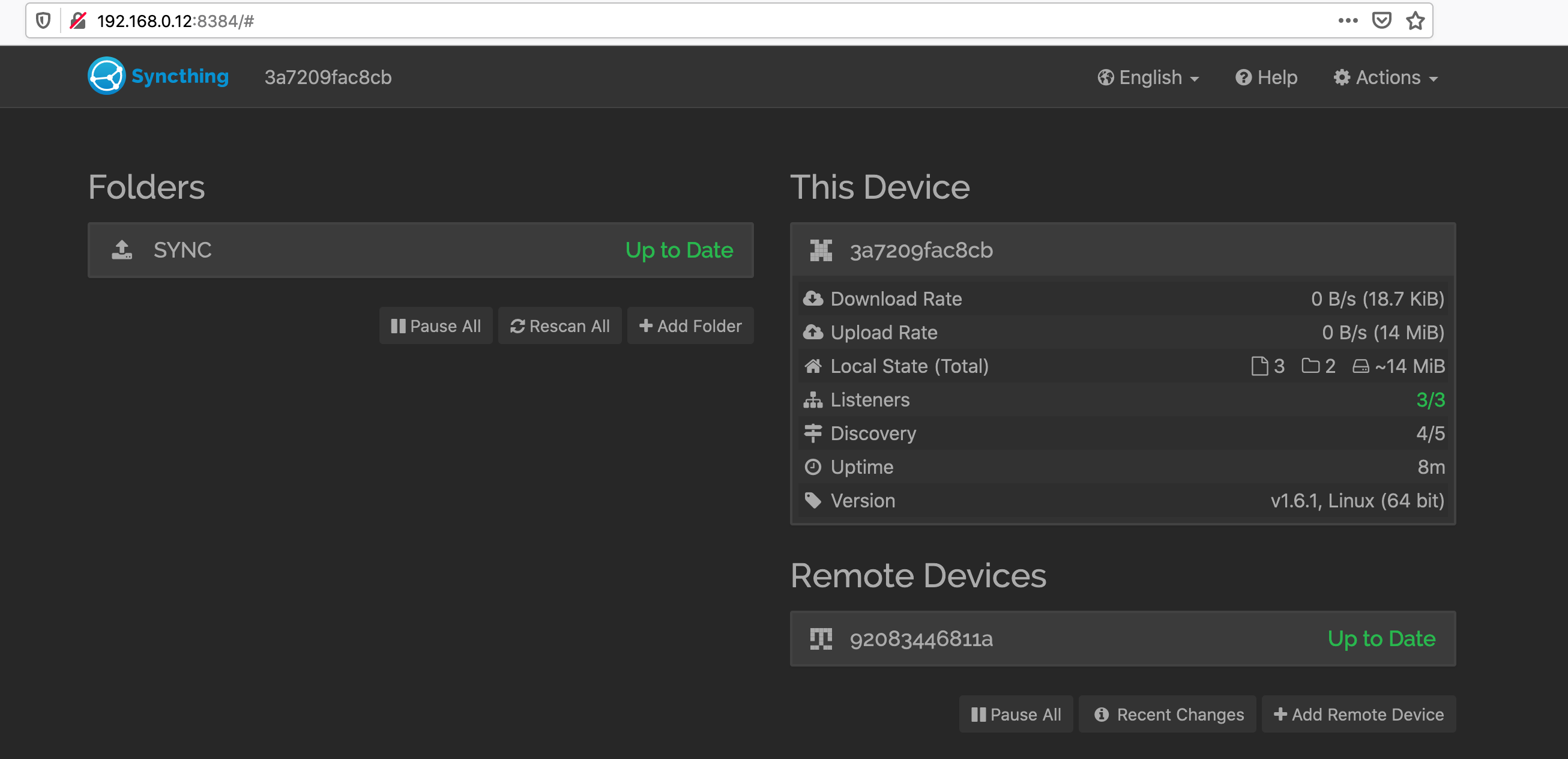

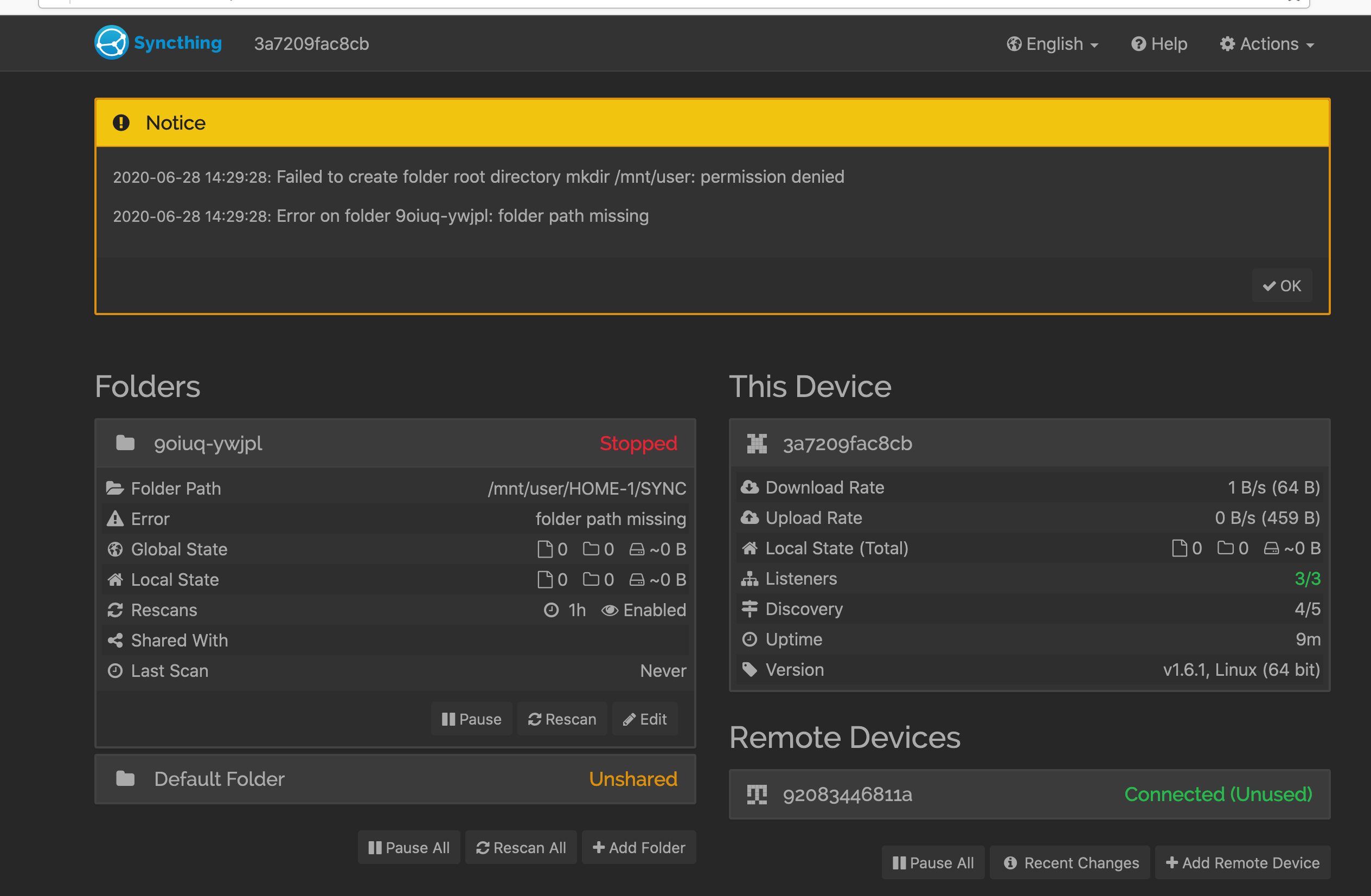

I've got Syncthing installed and configured / talking in both boxes but man, setting up a local directory to be synced between the 2 is not as intuitive as one would think :(  I am kind of stuck and asked for help on the Syncthing forum.  It shouldn't be that hard to set it up right?

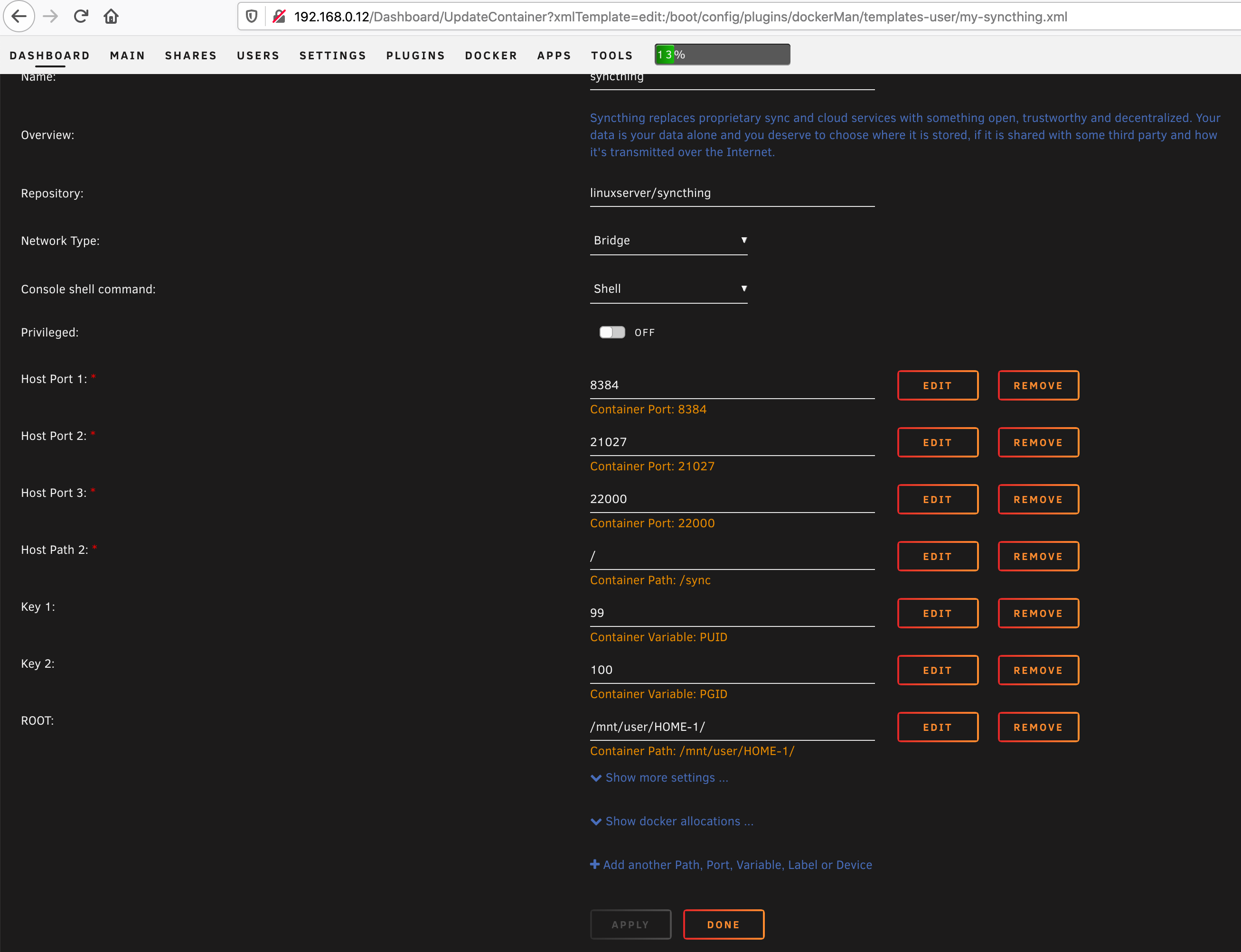

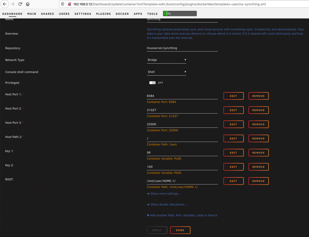

Well found the solution to my own problem :)  You'd could just add extra Host Paths as required, in my case / ROOT and be done with it :)   Work perfect now.
