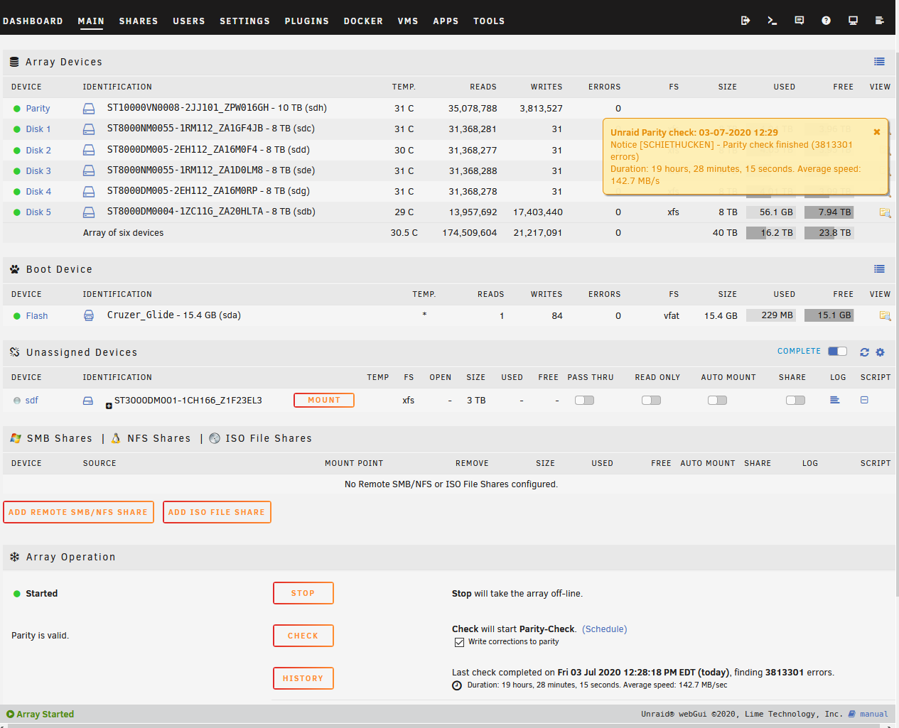

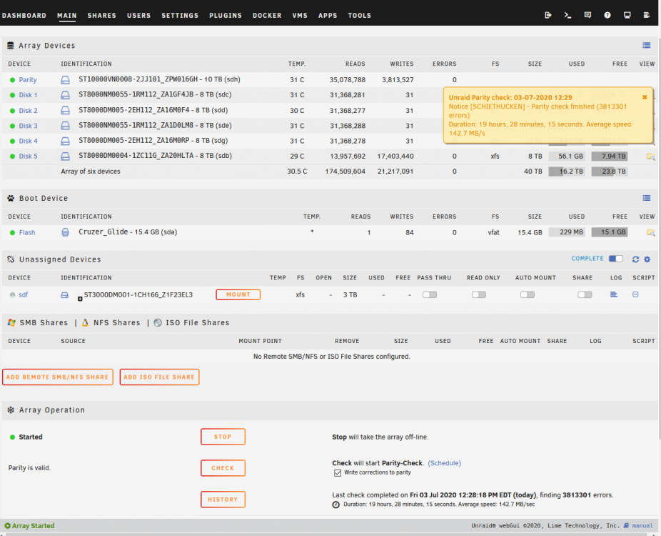

Awesome: Parity Swap resulted in the same errors! Did a Parity Swap and then Parity Check, without rebooting. Attached are:
Diagnostics before starting Parity Swap
Diagnostics after Parity Swap and Parity Check
Screenie at the end of the Parity Check with the result message.
Same amount of errors as before. Please let me know what needs to be done now. I'll keep the array running.
schiethucken-diagnostics-20200701-0923.zip schiethucken-diagnostics-20200703-1230.zip

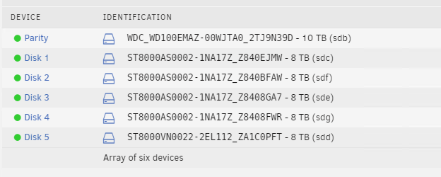

OK, there's definitely a problem, I managed to reproduce it with an identical array config:
My plan is trying to find out in which circumstances this happens, if it's disk size or config related, and then create a bug report, but since I can't reproduce this with small disks this can be a long and tedious process, I expect that @limetechis very busy at the moment with the latest beta and this isn't an urgent issue but if you have any idea what might be causing this with the info below please advise.
Quick summary:
-over the last couple of years or so multiple users, more than could be explained by just user error or other issues, have been complaining of sync errors after a parity swap, errors start on the extra parity section, i.e., if old parity was 8TB and new parity is 10TB sync errors start when you pass the 8TB mark on the check
-I could never reproduce this before on my test server but @Juniperwas willing to repeat the procedure twice so he/she could post the diags and both times it resulted in sync errors, looking at the diags procedure was correctly done as far as I could see.
-I was finally able to reproduce this using the exact same array config as the OP, like all other cases the sync errors start immediately past the old parity size:
