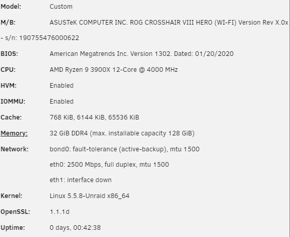

Hello
It's been a long time that i have this problem and today i try to test another time but it's not working.
When i add a cache drive 5 or 10 minutes after it's disconnect and do not work, if i restart the server the disk dissapear i have to unplug it and plug it.
When i see the log i found some blk_update_request: ERROR.
- I plug the ssd on the sata ports on my motherboard
- I try different different port on my motherboard and same problem.
I post my log in attachements.
Can someone help me?
Thank you very much.
