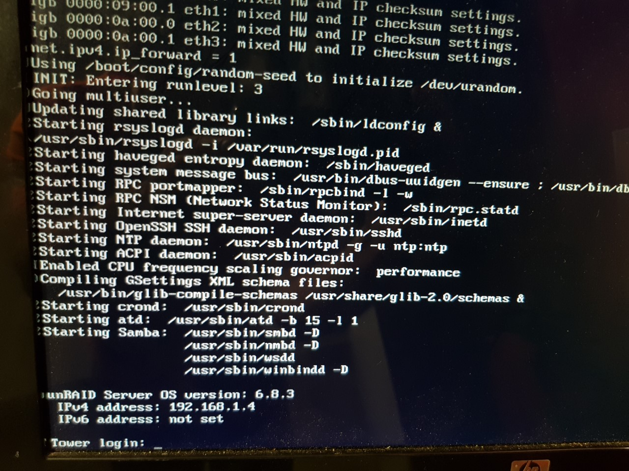

Ive just replaced my hardware (cpu,mobo,ram) and cannot access my system via webUI
Ive attached a monitor and keyboard to my system and can access bios just fine,
Unraid boots to the splashscreen where i can make a choice.
Unraid OS - Takes me to the following:
I can login at this cmd line
But i cant access the server via IP on another machine
Unraid OS with GUI - Takes me to a blank screen with a white - in the top right hand corner. And still no access via another machine
Lost on what to try next?

It could be that it's using a different NIC or the order changed, you can boot with GUI mode and change witch NIC it eth0
If i select boot with GUI, all i get is blank screen with a dash in the top left corner!
Can u put the unraid USB in a PC and change any settings manually??
Edited by bdydrp
Delete/rename network.cfg and network-rules.cfg both in the config folder, then boot again, you still might need to change the cable to a different NIC depending on witch one gets assigned by default as eth0.

Ive removed both files
Also removed the 4 port intel card so that its forced to use the onboard NIC
When unraid loads, i get to login
The lines
IPv4 - Not set
IPv6 - Not set
Should both network.cfg and network-rules.cfg files get re-created upon boot?
And an IP should be assigned via DHCP?
Also, selecting Unraid with WebUI, only loads to blank screen still!
Edited by bdydrp

But now at login screen, IPv4 is not set.
Something is causing it to not get an IP from my DHCP.
Possibly an issue with my onboard NIC??
