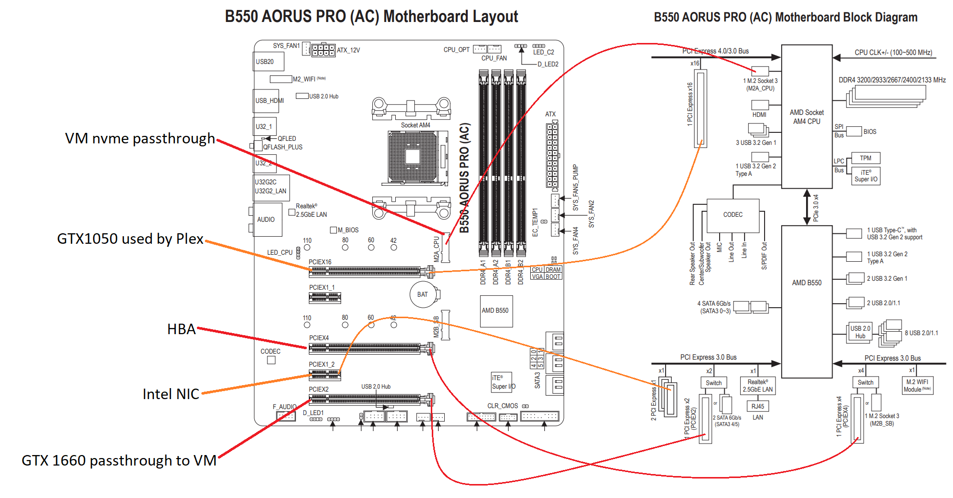

What is your setup?
In what slot are the two gpu:s connected?
11 hours ago, TIE Fighter said:
What is your setup?
Ryzen 3900x
Gigabyte B550 Aorus Pro
Hope this isn't too messy.
Actually I just tried running Plex with HW transcoding while the VM is shut down, and it definitely isn't working normally.
On the previous server, using the same GPU (1050), streams with HW transcode would play almost immediately.  Right now, it hangs for a while.  And then if I play another stream, nvidia-smi reports only one process despite two streams.  Previously all streams would be reported in nvidia-smi.
There's definitely something funky going on, will need more troubleshooting.

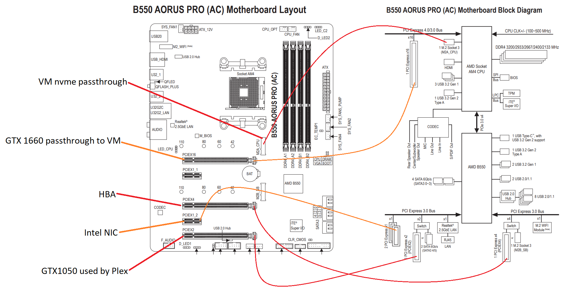

Hm...all I did was swap the gpus in each other's pcie slots and it's resolved this issue.  Not sure why that would have an impact, but...there you go.
