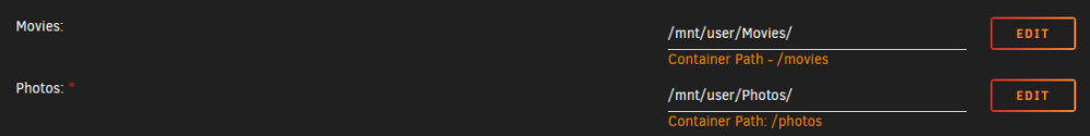

If you are running Plex in a docker container, it is all in the container setup.  I have shares for every media type I want to add in Plex.
My setup looks like this (with a container/host mapping for each media type):
And yes, those volume mappings will appear in the docker run command.
You need to read the Docker FAQ trurl linked to understand Docker volume mappings.
In the case of transmission, you have told it to specifically use disk1 and only disk1.  You should switch it to the 'user' path rather than a specific disk.
