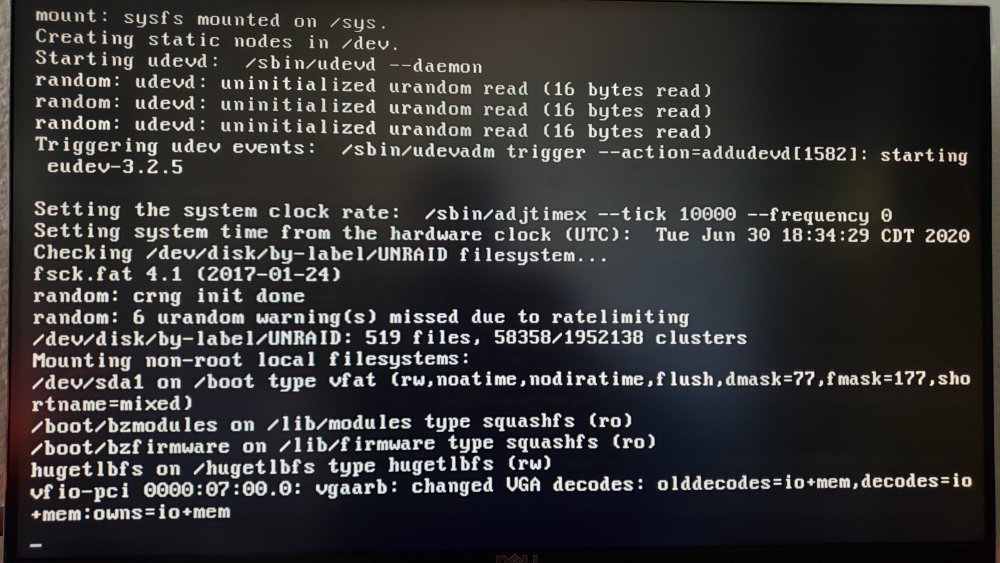

UNRAID 6.9 won't start after messing with IOMMU groups on new Ryzen build
I've been trying to sort out issues with my new Ryzen 7 Unraid build for the past 2 days and I finally got it running. I then attempted to get my VMs working by following spaceinvader one's tutorials. I was messing with IOMMU groups (I'm a bit ignorant on the subject) and changed the PCIe ACS Override to "BOTH". Upon reboot, Unraid will not start up (see attached). I wish I could post diagnostics but I am unable to type any commands. This has been an endless headache. Please help.
Edited by bubbleman441
Wait 10min and try to login. Maybe you bind your gpu
Waited about 30 min. Server won't boot. I'm thinking about putting all of my old hardware back in.

4 hours ago, bonienl said:
Start your system in safe mode and undo the ACS override setting.
Same issue with safe mode. Can't boot server.

What was the solution ?
I am facing the exact same issue 🙄
Ok I found the solution
I put the USB key to my computer and I restored the file:
/boot/config/vfio-pci.cfg.bak to /boot/config/vfio-pci.cfg
  • 1 year later...
You are a life saver. I'm having networking issues and figured I'd try upgrading the bios. I forgot to enable IOMMU, and unraid booted fine. After enabling it, it would not boot. I made this change, and I can boot back in. Thank you.
